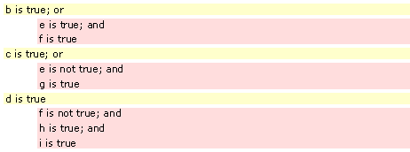

If we have a rulebase which contains the following rule:
And an input data set of:

Note: We are asking for the value of "a" in the global entity as a outcome. We are setting the value of the attributes "e", "g" and "i" (also in the global entity) to false. In the example we are asking for "a" to be displayed with the outcome style "value" only. Below there are examples of the three report styles "value-only" "decision-report" and "base-attributes".
For the outcome attribute "a", we get the following Decision Reports:

For the report-style "decision-report", the Determinations Server response reports that the attribute "a" is known and is false. Also, the response has a Decision Report containing decision nodes that describe how the value of "a" was determined.
The first node in the decision report is for the attribute id "b". It tells us that b is known and is false. Sub-nodes of this node explain that the values for "e" (false) and "f" (unknown).
Next there is a node explaining the value of "c" (known and false). Sub-nodes of this node explain the values for "e" and "g". Because the value for "e" has already been explain earlier, an already-proven element appears.
The third top level node explains the value of "d" (known and false). The three sub-nodes of this node explain the values of "f", "h" and "I". because "f" has already been proven for the node for "b" an already-proven element appears.
