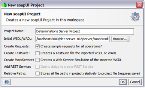

  3. Choose File > New soapUI project and give the project a name of your choice, but for the initial WSDL/WADL, put the WSDL for the Determinations Server. For java this will be http://<server>:<port>/determinations-server/server/soap?wsdl and for .NET this will be http://<server>:<port>/determinations-server/server/soap.asmx?wsdl
  4. Click OK

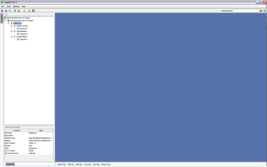

soapUI will create a new project and import the WSDL into that project giving you a service definition named odsServer. If you left the option Create sample requests for all operations on, you will have a sample operation for the three Determinations Server Service Operations: GetServerInfo, ListRulebases and LoadRulebase.
If an error occurred, it is probably because the Initial WSDL URL is incorrect.

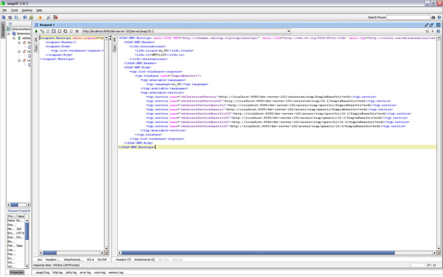

  2. On the left hand side of soapUI, go to the ListRulebases operation and expand it so you can see Request 1. Double-click on that request to open it. Notice that the request has been created by soapUI. Because there are no parameters needed for a ListRulebases operation, you can run this operation without modification. To run this operation, click on the green arrow in the top lefthand corner of the request panel.
  3. The response should appear in the right hand panel. In the screenshot below, you should be able to see that there is one rulebase, “SimpleBenefits”, deployed to this Determinations Server along with the list of language(s) supported by that rulebase and the WSDL URLs for all services available for that rulebase.

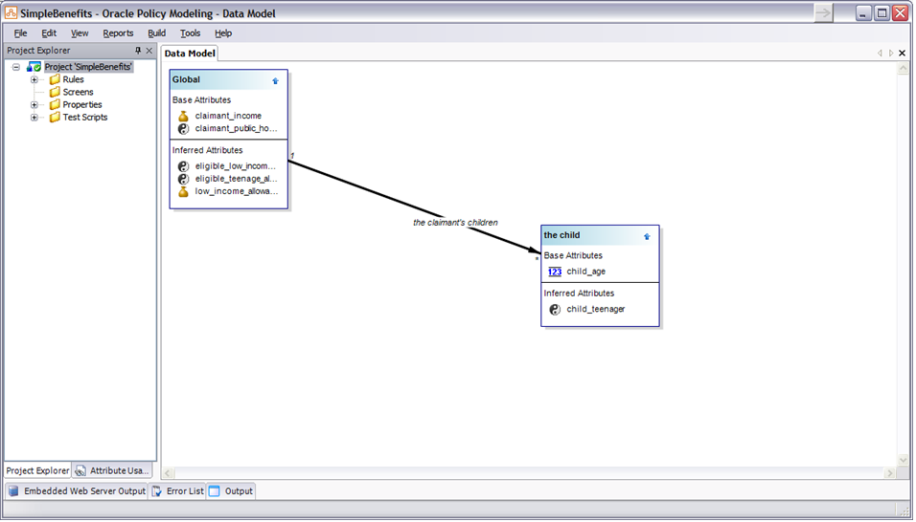

Looking at the Data Model for the Simple Benefits rulebase (examples\rulebases\compiled\SimpleBenefits.zip in the Oracle Policy Automation Runtime package), we can see that the Global has some attributes and a relationship to the child entity.
For this example we will investigate the goal “eligible_low_income_allowance” and “eligible_teenage_allowance”.
