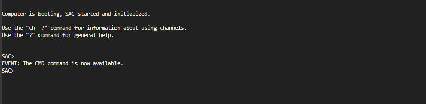

- Connect to the serial console. If SAC is enabled, the
SAC>prompt appears in the serial output. For more information about SAC commands, see Emergency Management Services Tools and Settings in the Microsoft documentation.
- To view a list of SAC commands, enter ? and then press Enter.

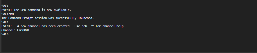

 - Create a command prompt channel (example:

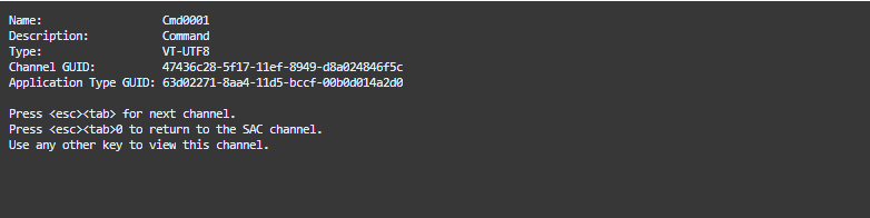

cmd0001), entercmd, and then press Enter. - View the command prompt channel, press ESC and then press TAB.
- To switch channels, press ESC+TAB+<channel number> together. For example, if you created a second channel named
cmd0002, to switch tocmd0002, press ESC+TAB+2.

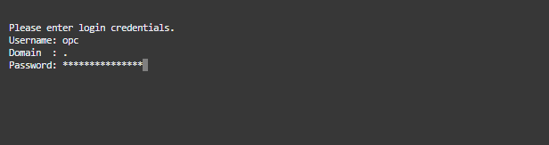

 - Enter the credentials required in the command prompt channel.
The command prompt has the same command shell features that you get on a desktop, except that it does not allow the reading of characters that were already output.
