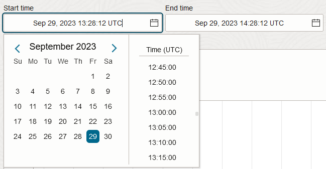

By default, charts show the last hour of metric data. For information about time range on default charts, see Changing the Time Range for Default Metric Charts. (Time range isn't available for the metric chart displayed while creating or editing an alarm.)
- Note
The default time range for CLI and API is the last three hours.Use the oci monitoring metric-data summarize-metrics-data command and required parameters to query metric data. Use the
--start-timeand--end-timeparameters to select a nondefault time range for the query.oci monitoring metric-data summarize-metrics-data --start-time <time_rfc3339_format> --end-time <time_rfc3339_format> [...]Example value for start or end time:
2023-09-29T13:58:00.000ZFor a complete list of parameters and values for CLI commands, see the Command Line Reference for Monitoring.
