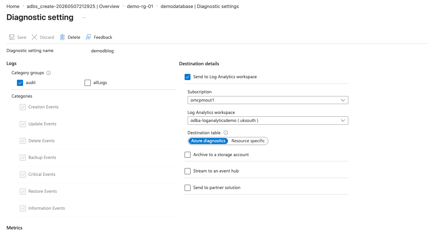

  • Set Up Log Analytics for Oracle Autonomous AI Database Service
    1. From the Azure portal, select Oracle AI Database@Azure.
    2. From the left menu, select Oracle Autonomous AI Database.
    3. From the list, select your Autonomous AI Database that you want to monitor.
    4. Expand the Monitoring section, and then select Diagnostics settings.
    5. Select the Add diagnostic setting button. To enable Diagnostic settings ,configure the following event data:
      • Creation Events
      • Update Events
      • Delete Events
      • Backup Events
      • Critical Events
      • Restore Events
      • Information Events
      1. On the Diagnostic Settings page, enter a descriptive Diagnostic setting name and then select the audit option under Category groups in the Logs section.
      2. Select Log Analytics Workspace as the destination detail that you created earlier, and then select the Subscription and the Log Analytics workspace.
      3. Review your information and then select the Save button to save your settings.
    This screenshot shows how to create diagnostic setting.

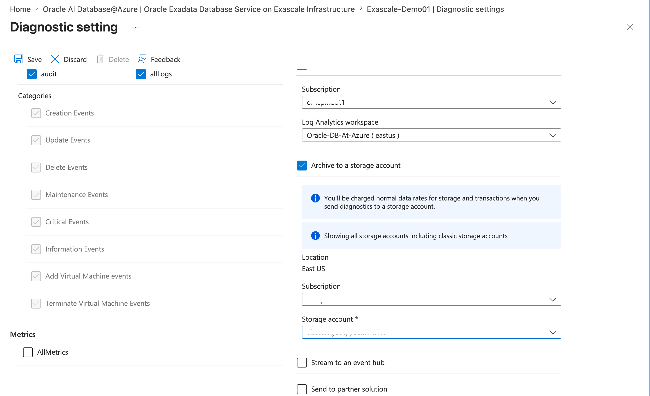

  • Set Up Log Analytics for Oracle Exadata Database Service on Exascale Infrastructure
    2. From the left menu, select Oracle Exadata Database Service on Exascale Infrastructure and then select VM Clusters tab.
    3. From the list, select your Exascale VM Cluster that you want to monitor.
      • Creation Events
      • Update Events
      • Delete Events
      • Backup Events
      • Critical Events
      • Restore Events

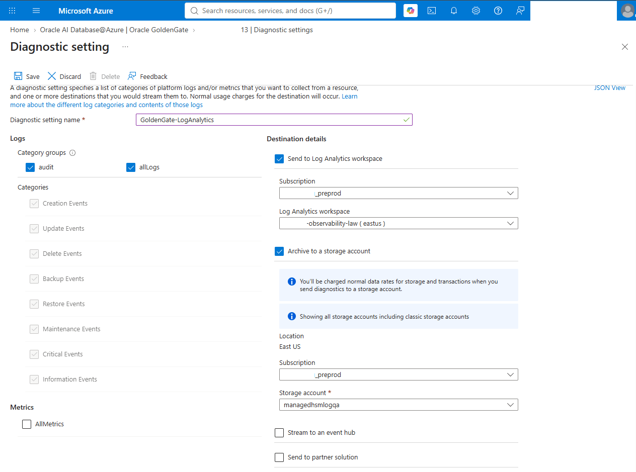

  • Set Up Log Analytics for Oracle GoldenGate
    2. From the left menu, select Oracle GoldenGate, and then select Oracle GoldenGate Deployments tab.
    3. Select your deployment that you want to monitor.
      • Creation Events
      • Update Events
      • Delete Events
      • Backup Events
      • Critical Events
      • Restore Events
      1. On the Diagnostic Settings page, enter a descriptive Diagnostic setting name, and then select the audit option under Category groups in the Logs section.
      2. Select the Send to Log Analytics workspace checkbox, and then select the Subscription and the Log Analytics workspace.

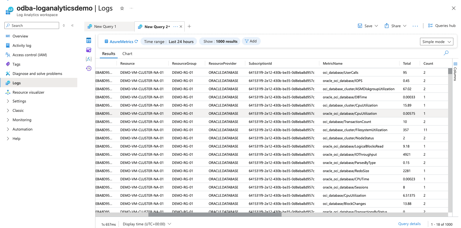

  5. Explore Data (Simple mode)
      • By default, you can see the Simple mode, which provides a spreadsheet-like experience.
      • Use point-and-Select filters, sorting, and aggregation to explore available log data.
      • Ideal for quick checks such as recent errors, activity logs, or resource health events.
    Note
    Few metrics, such as CPU Utilization, can appear multiple times with different labels. For example, CPU Utilization (OCI Database Cluster), CPU Utilization (OCI Database), and CPU Utilization (Oracle OCI Database).
    • OCI Database Cluster is for the VM Cluster metrics.
    • OCI Database is for the Container Database metrics.
    • Oracle OCI Database is for the Pluggable Database metrics.
    This screenshot shows how to monitor logs.

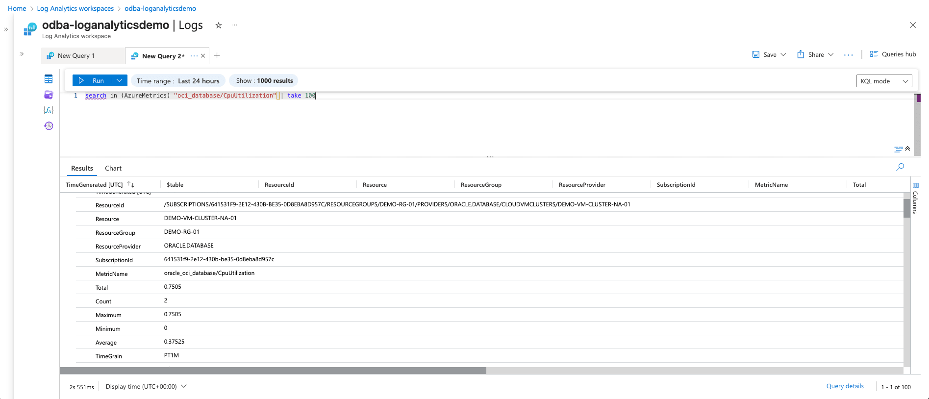

  6. Query Data Using KQL (Advanced Mode)
    1. From the dropdown, switch the mode to KQL mode.
    2. Browse available tables shown on the left side. For example:
      AzureMetrics, OracleCloudDatabase, Usage
      For more information, see the table reference AzureMetric s, OracleCloudDatabase, and Usage.
    3. Run a basic query. For example:
      1. The following query lists CPU Utilization Metrics of all resources in the Exadata Infrastructure which includes VM cluster, Container Database and Pluggable Database.
        search in (AzureMetrics) "CpuUtilization" | take 100
      2. The following query lists CPU Utilization Metrics of all Container Databases.
        search in (AzureMetrics) "oci_database/CpuUtilization" | take 100
      3. The following query lists CPU Utilization Metrics of all Pluggable Databases.
        search in (AzureMetrics) "oracle_oci_database/CpuUtilization" | take
            100

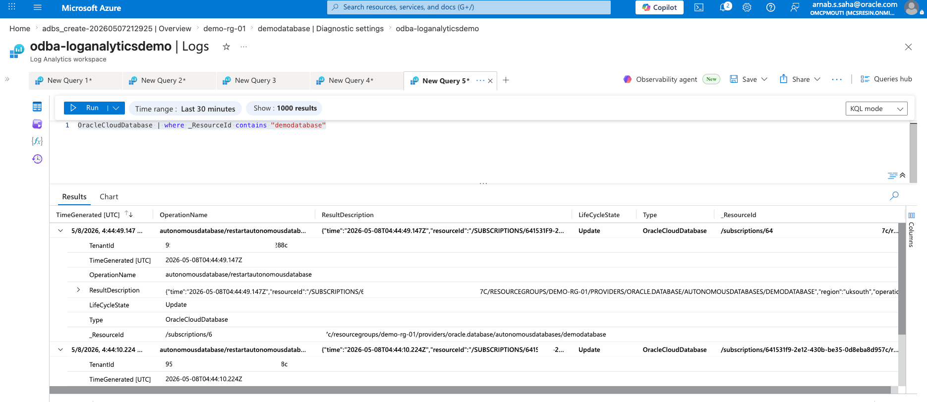

      4. The following query lists all events in the Autonomous AI Database Serverless for the last 30 minutes. This screenshot shows how to monitor logs.
  7. Convert query results into charts, graphs, or tables directly from the query results pane.

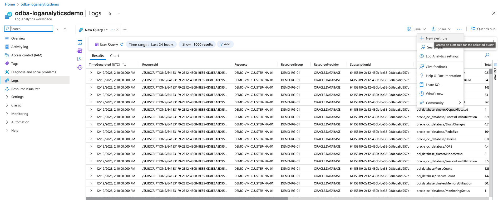

Create Alert Directly from a Log Query
  1. From the Azure portal, navigate to Log Analytics workspaces.
  2. From the list, select the workspace that you want to view.
  3. From the left menu, select Logs. This opens the Log Analytics query editor.
  4. Run your query and verify the results.
  5. From the Logs query window, select the ... icon and then select the + New alert rule option. From the Create an alert rule page, enter the following information.
    1. In the Scope section, the required fields are populated automatically.
    2. In the Condition section, confirm the Search Query condition and then set the following based on your requirements:
      • Measurement: Measure for the aggregation, Aggregation type, Aggregation granularity
      • Alert logic: Operator as Greater than, Threshold value and Frequency of evaluation
