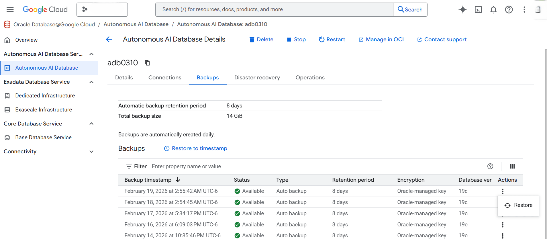

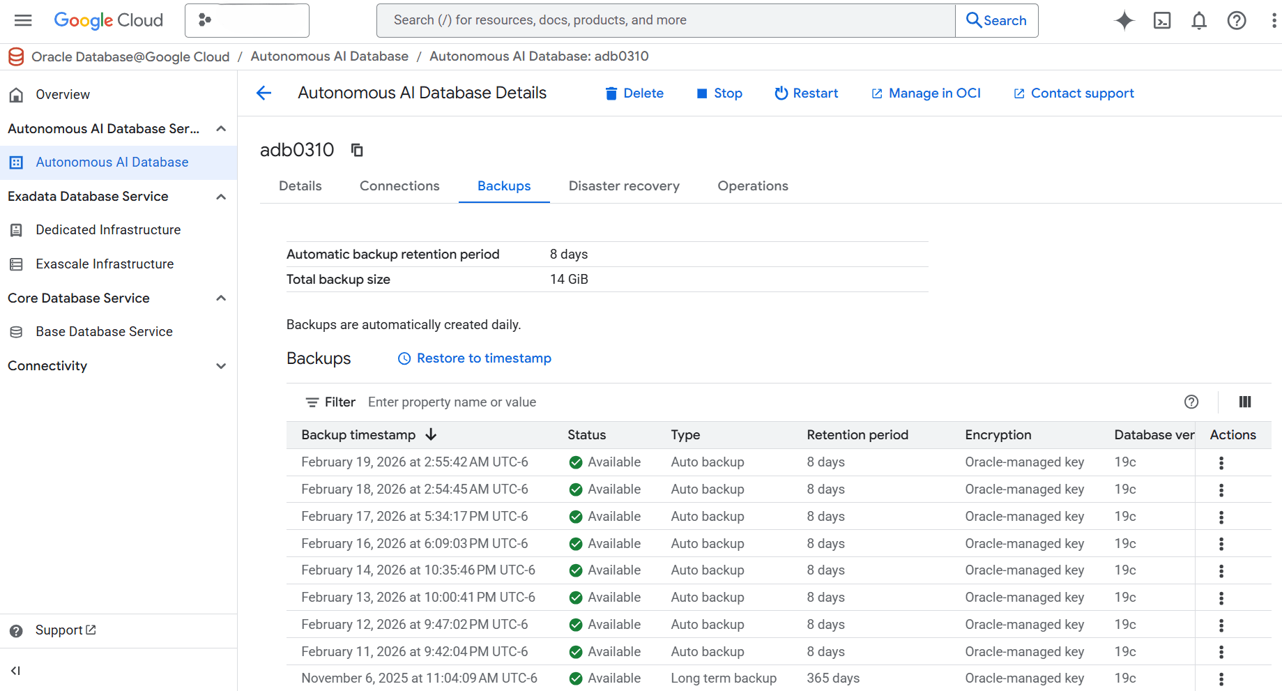

  • View Autonomous AI Database Backups
    1. View your Autonomous AI Database backups in the Oracle AI Database@Google Cloud dashboard, select your Autonomous AI Database and then select the Backups tab. You can review your automatic backups and long-term backups with their retention periods.This screenshot shows the backups tab of Autonomous AI Database.
    Restoring an Autonomous AI Database is available through the OCI Console and Google Cloud Console.
    Restore from Backups
    1. From the Oracle AI Database@Google Cloud dashboard, select Autonomous AI Database.
    2. From the list, select your Autonomous AI Database, and then select Backups tab.This screenshot shows how to restore from backups
    3. From the Backups list, select the Backup timestamp that you want to restore. Then, under Actions, select the More options icon then choose Restore.

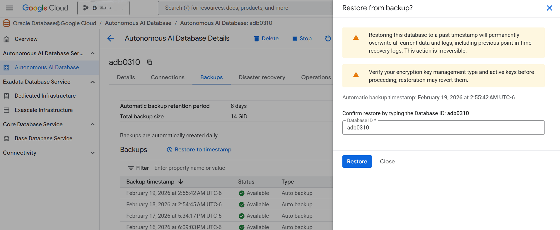

      1. From the Restore from backup page, enter your Autonomous AI Database ID to confirm the restore process.
      2. Select the Restore button to start the restore process.

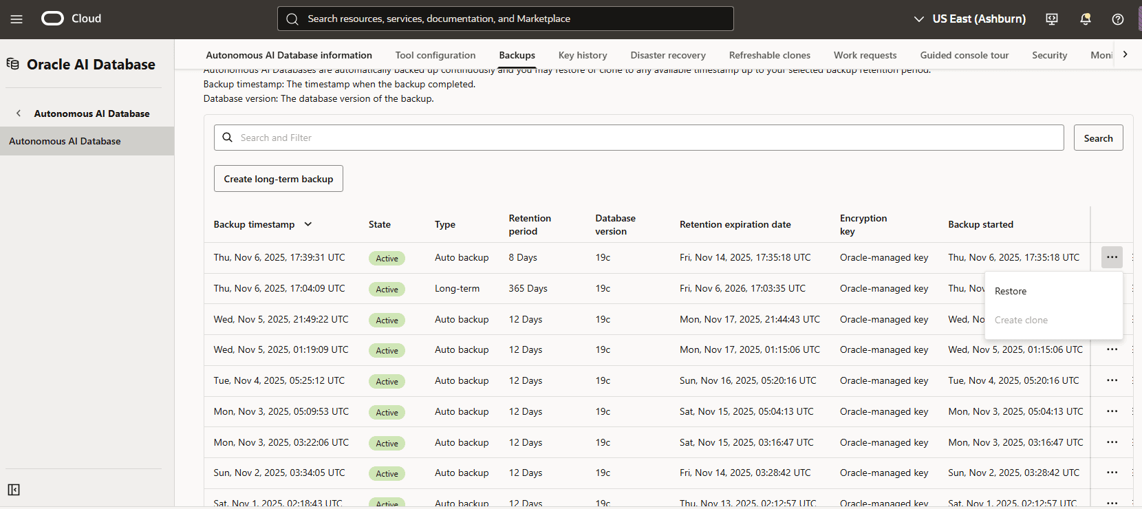

  • Restore from Automatic Backups
    1. In the OCI console with your Autonomous AI Database, select the Backups tab, select the specific backup, select the ..., and select Restore from the submenu.
      A screenshot of the process for restoring an automatic backup of an Autonomous AI Database

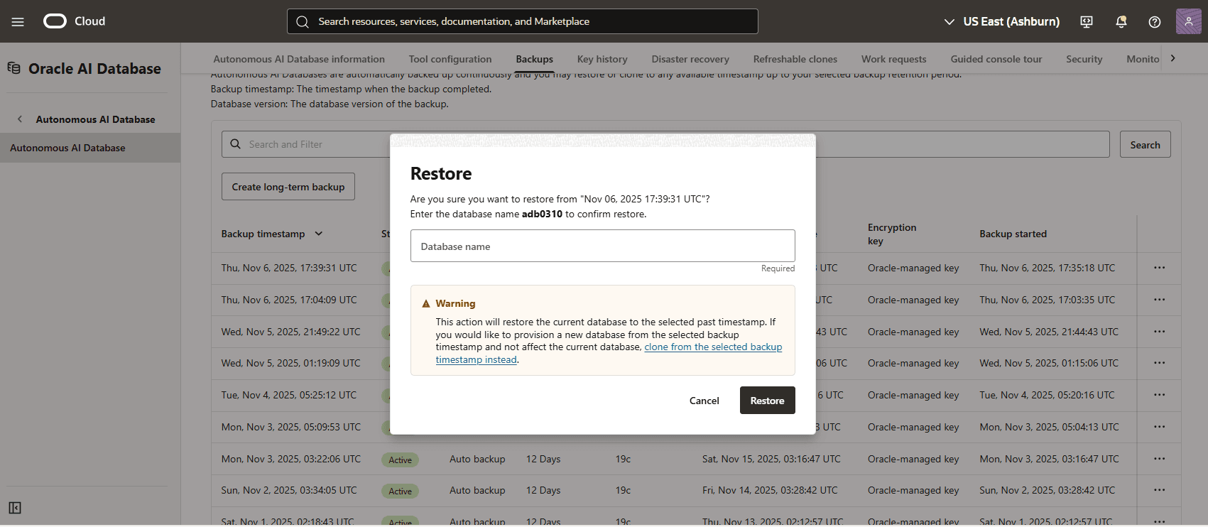

    2. At the Restore modal window, the Warning message appears. Enter the name of the Autonomous AI Database in the Database name field, and then select the Restore button.

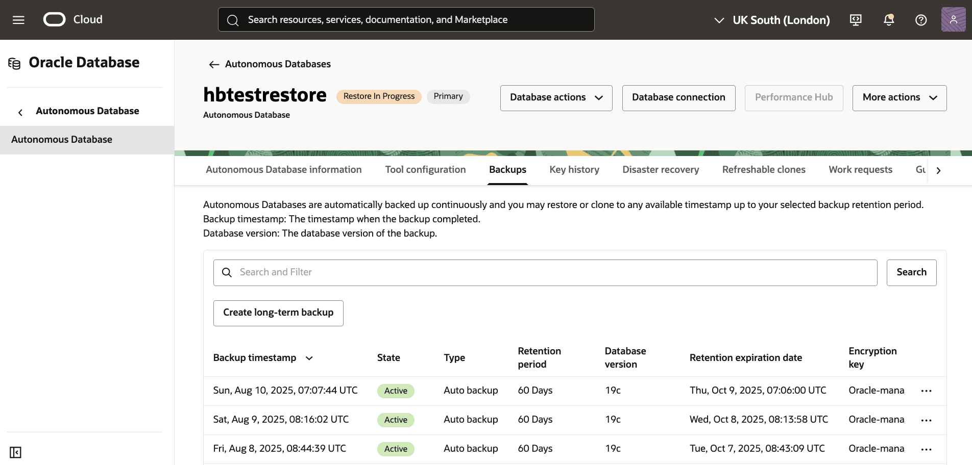

    3. Return to the Backups tab within your Autonomous AI Database to view the status of your restore request. Once the restore process is complete, the status will change from Restore in Progress to Active.
