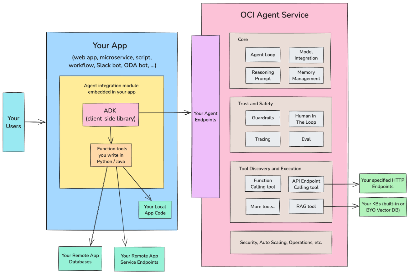

Overview
Follow this two-step guide to provision, set up, and run an agent.
Step 1: Provision an agent with an endpoint in the OCI Console
In this step, in the OCI Console, create an agent instance and an endpoint for the agent. You don't need to add any tools to this agent. This step is about infrastructure setup and you use the OCI Console to do it. You can also create an agent instance and its endpoint through OCI SDK or with Terraform.
Note: Configuration instructions or tools for the agent instance are covered in Step 2.
Step 2: Configuring and running agent using the ADK
In this step, use the ADK to set up and run your agent. For setting up your agent, you can iterate with your instructions and tools locally. After your agent is set up locally, push the agent information to the remote agent instance by running the agent.setup() method. For a running agent, run the agent.run() method to fulfill requests, without having to write code for handling the low-level
client-server interactions such as managing sessions, finding and invoking functions, and so on.

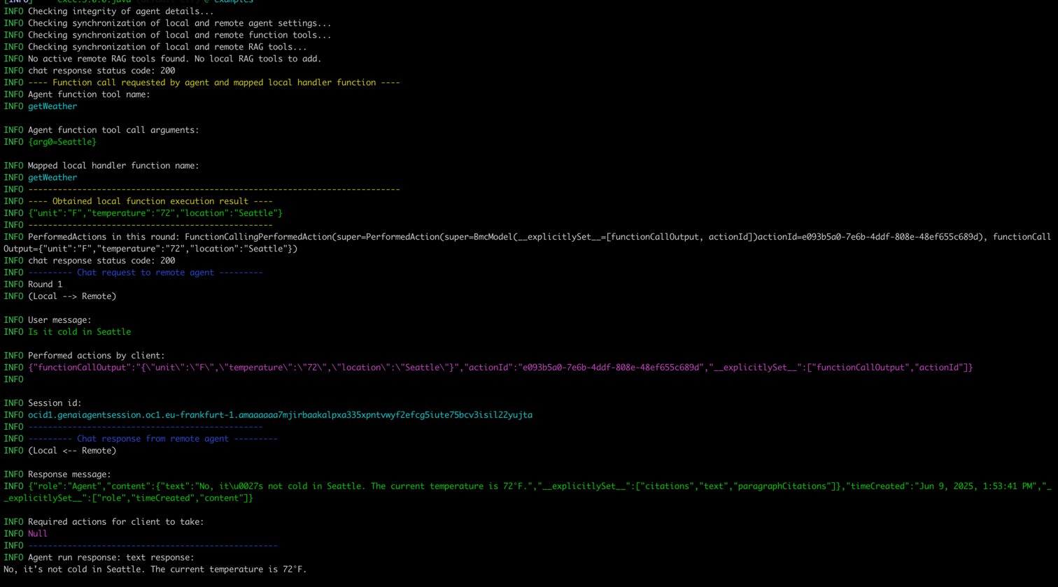

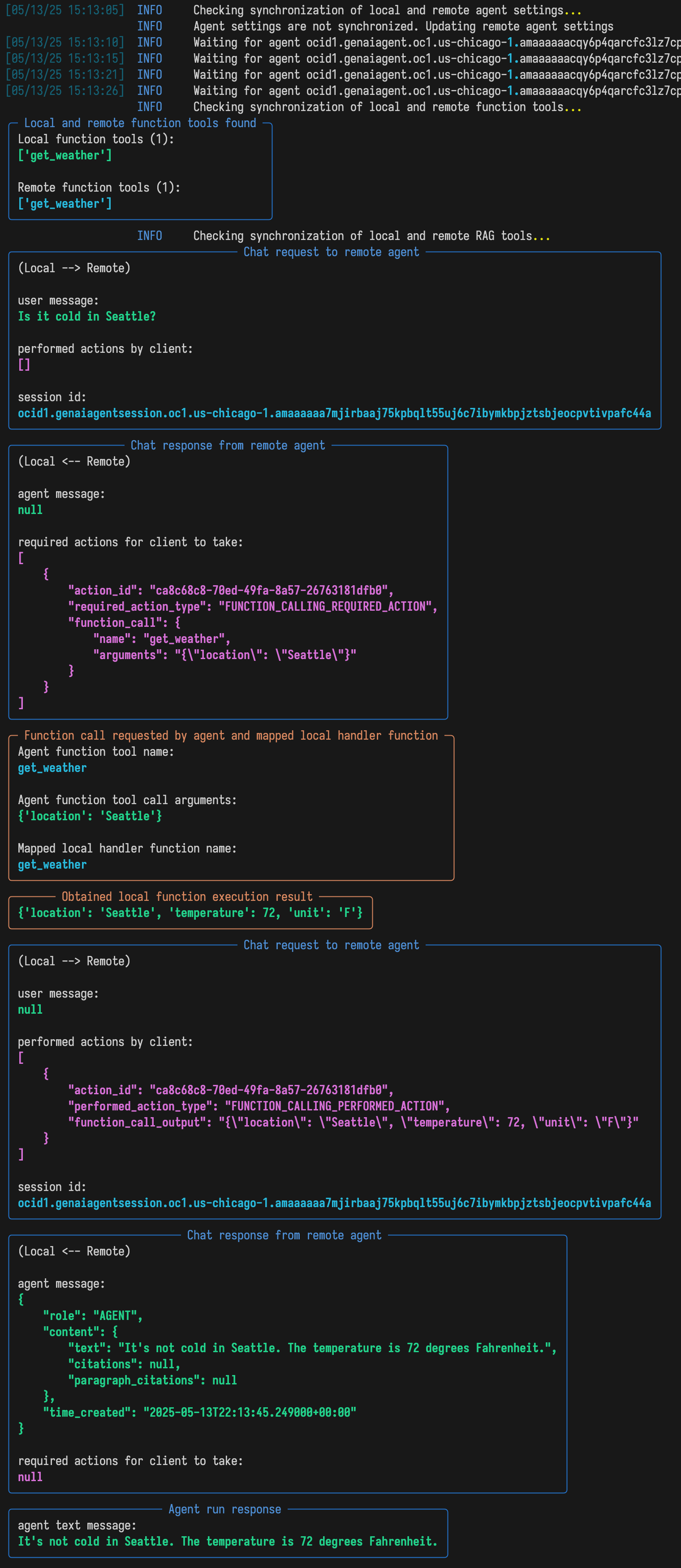

Run the script
Then run the quickstart.py script, and you should see the output like this:

You should see the output like this:

Now you have a simple weather agent using ADK running locally, with outbound connection to your agent endpoint on OCI.
Note: Why do you need an agent endpoint? Can you use ADK locally without a remote agent endpoint?
ADK requires an agent endpoint to function much like a client-side agent framework needs an LLM endpoint. Think of the agent endpoint as an enhanced LLM endpoint, offering advanced agentic features such as optimized reasoning prompts and server-side tools from OCI. ADK doesn't support direct connections to raw LLM endpoints.
This agent is equipped with a local custom function tool get_weather that you implemented.
The agent is ready to handle your user's request expressed in natural language.
Behind the scenes, the ADK handles the low-level client-server orchestration, while the agent endpoint handles running the core agent loop, talking to an LLM, and potentially invoking other hosted tools such as a RAG tool (not implemented in this quickstart).
How it Works
Typically your ADK code is embedded in a larger app and is deployed in your environment. Your larger app might be a web app, a Slackbot, a service, or a a script.
Through ADK function tools, you can integrate an agent with your local codebase, your remote databases, remote microservices, and so on using the authentication that's native to your environment.
The ADK calls the agent endpoint, exposed by OCI Generative AI Agents service, which runs the agent loop remotely to your environment.
When the agent loop decides to call a hosted tool (like a RAG tool), that calls happens without going back to ADK.
When the agent loop decides to call the local function tools, the control is returned back to the ADK. The ADK calls your local function tools, and submits the function tool output back to Generative AI Agents, which then continues the next iteration of the agent loop.
