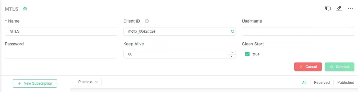

  • Use any MQTT client to subscribe to a topic using MQTTS. This example uses MQTTx.
    To send sample data and test the connection:

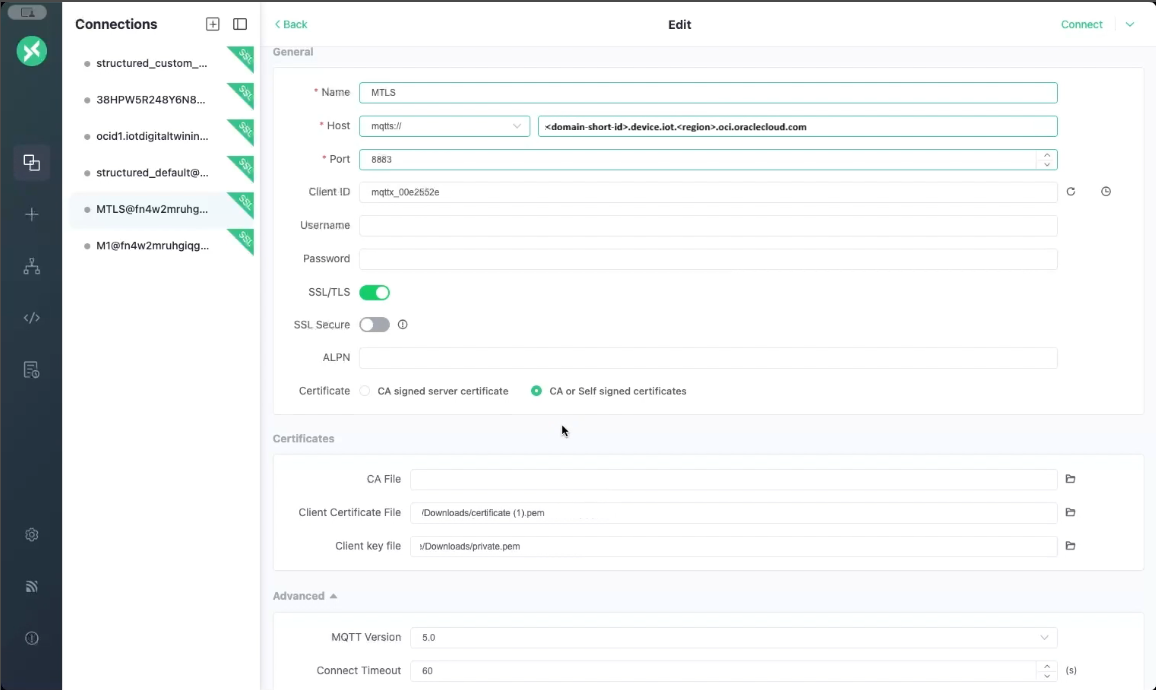

    1. Enter the device host as the host, for example:
      mqtts://<domain-short-id>.device.iot.<region>.oci.oraclecloud.com
    2. Enter the port: 8883
    3. Client ID: your-client-id
    4. Clean Start: True
    5. Turn on the toggle to enable TLS.
    6. Select the option: CA or Self signed certificates
    7. Enter the client certificate file location, from step 15 in Create a Certificate that's Managed Externally: your-certificate.pem
    8. Enter the client key file location, from step 1 in Generate a New Private Key: your-private-key.pem
    9. Select Connect.

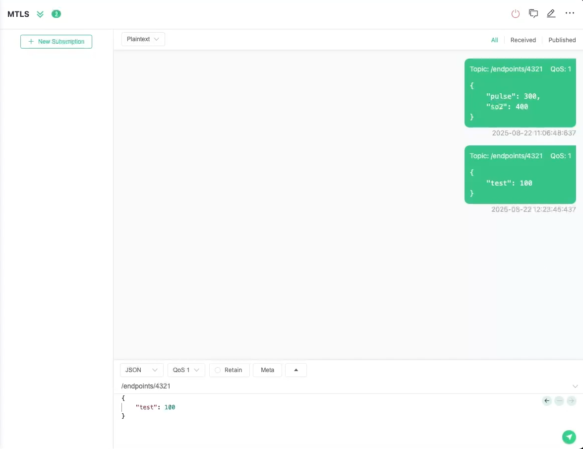

    10. Select New Subscription to receive data from a device.
    11. Enter the endpoint as the Topic.
    12. This example shows messages published to the /endpoints/4321 topic, at Quality of Service (QoS) level 1. topic:
        "pulse": 300,
        "s02": 400
        "test": 100
