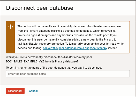

  1. On the cross-region peer, on the Autonomous AI Database details page, under Disaster recovery in the Role field click Disconnect peer.
  2. On the Disconnect peer database dialog, enter the peer database name to confirm the disconnect.
  3. Click Disconnect.

  3. On the Disconnect peer database dialog, enter the peer database name to confirm the disconnect.
  4. Click Disconnect.
