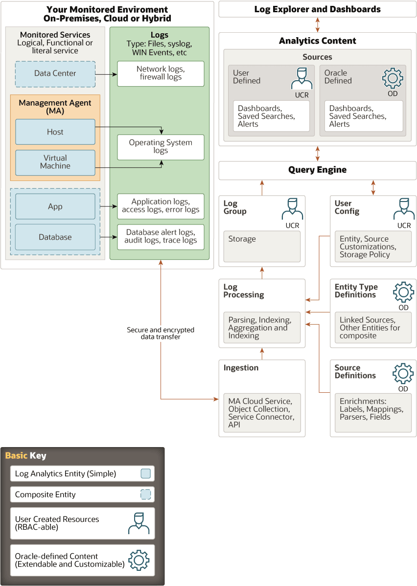

Architecture of Log Analytics
Here's the high level architecture of Oracle Log Analytics service:
High level architecture of Log Analytics
