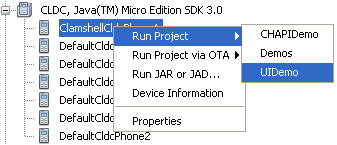

    To run the project on a different device, choose the device in the Device Selector window. Right-click on a device and select Run Project from the context menu. Pull right to see a listing of suitable open projects. If the project you want is not listed, select a different device.
    run project from device manager context menu
    The device emulator window opens with the demo application running.
