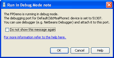

  1. Select the project you want to debug and select Run > Run Project in Debug Mode or click the Run Main Project in Debug mode icon on the toolbar.
    The first time you debug you see this dialog.
    run in debug mode note with port
  2. Make note of the debugging port for the device, and click OK. If you suppress this dialog you can still get the port number from the Output window. Look for the message “Starting emulator with port number port-number”.
    The application is now deployed and started on the connected device. You are ready to attach a debugger.
