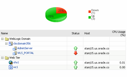

The WLS_PORTAL service is down.
Display the domain home page (for your Oracle Portal instance), in Oracle Fusion Middleware Control. See Section 8.1, "Using Oracle Enterprise Manager 11g Fusion Middleware Control" for more information.
The WLS_PORTAL status is displayed in the System Components table.
If the status is 'Up', then continue to the next step.
If the status is 'Down', then start WLS_PORTAL using Oracle Fusion Middleware Control.
To access WLS_PORTAL monitoring and administration pages in Oracle Fusion Middleware Control, click WLS_PORTAL in either of the following:
Parallel Page Engine Services page (available from the Component Status table on the Oracle Portal home page)
Fusion Middleware System Components table
If WLS_PORTAL starts successfully, check whether your portal is now accessible.

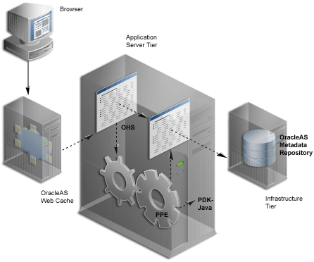

Oracle Portal makes use of an ECID, which is a unique number that is assigned to a request and attached to the information recorded for that request. As a request is passed from one component to another, the ECID can be incremented to form a sequence. This means that an individual request can be tracked through any number of components by following this ECID sequence.
An ECID is generated by the first Oracle Fusion Middleware component to receive a request without an ECID. You can observe this generation and propagation in Figure H-2, where a dotted arrow depicts a request with an ECID.
Figure H-2 Request Flow with ECID Generation and Propagation
ECID generation is available in Oracle Web Cache, Oracle HTTP Server, and the Parallel Page Engine (PPE). An ECID is generated only if it does not already exist. In this release, logging of portal invalidations in Oracle Web Cache now includes the ECID of the original request. This can be used to relate invalidations to original edits or personalizations.

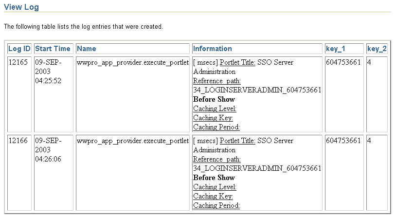

You can view PDK log entries from the same page used to configure PDK logs, as shown in Figure H-4.
Figure H-4 Log Entries in the PDK Logging Page

View the servlet log file for the recorded performance information. This information will be in a format similar to the following:
4/23/02 5:38 AM portal: [perf] Information for Portlet 33,31071. Portlet Timing: 234 msecs (wait=0) Timing Status: XSLT Timing: null msecs Caching information of portlet: Portlet Cache status: <I>Web Cache:-</I> MISS,NON-CACHEABLE [N], <I>File System Cache:-</I> MISS,NEW From Cache: <I>Web Cache:-</I> -, <I>File System Cache:-</I> None From Portlet: Cache Key: NORMAL, Cache Level: USER 4/23/02 5:38 AM portal: [perf] Information for Page 33%2C31060%2C33_31062 Elapsed Time: 2470 msecs Page meta-time 7 msecs (wait = 994) Page meta Cache Status: <I>Web Cache:-</I> MISS,NON-CACHEABLE [N], Cache Expires: null secs, Age in Cache: null secs , <I>File System Cache:-</I> MISS,NEW Login meta-time 1227 msecs (wait = 1) Login meta Cache Status: <I>Web Cache:-</I> MISS,NON-CACHEABLE [N], Cache Expires: null secs, Age in Cache: null secs
