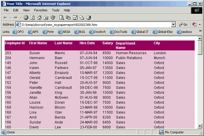

Click the Run Web Layout button in the toolbar to display your new JSP-based Web report in your browser. The report should look something like this:
The report displays, in Web format, the employee data you specified. Here, you can see employee details, such as their name, email, hire date, salary, department to which they belong and their location.
