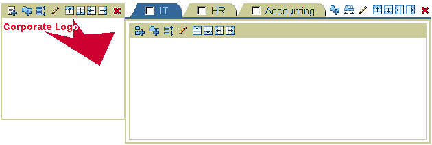

If there is a portlet or item you want to display no matter what tab is active—say, a link to your corporate Web page—divide your page into two regions: one containing the portlet or item, the other containing the tabs (Figure 10-40).
Figure 10-40 A Region for a Logo and a Region for a Tab Set
Two regions, one with no tabs and one with three

10.3.8.2 Deleting Multiple Tabs Simultaneously
To delete multiple tabs simultaneously:
  1. Log in to Oracle Portal.
  2. Click the Build tab to bring it forward.
  3. From the Page Groups portlet Work In drop-down list, select the page group that owns the page where the tabs are located.
    By default, the Page Groups portlet is located on the Build tab of the Portal Builder page.
  4. Under Pages in the Layout & Appearance section, click the link to the page where the tabs are located.
    This opens the page in Edit mode.
  5. Click the Editing Views: Layout link in the toolbar at the top of the page.
  6. In Layout view, select the check box next to each tab you want to delete.
  7. Click Delete.
  8. In the confirmation page, click Yes.
    All of the selected tabs and their content are deleted.
