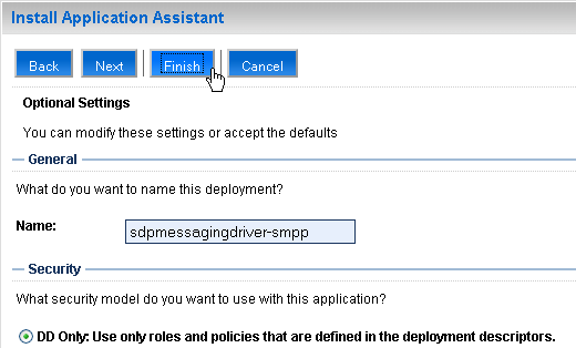

In the Domain Structure region of the console, click Deployments. The Home page for Deployments appears.
Under Deployments, click Install.
The Install Application Assistant appears. Use this page to locate the application you want to deploy.
Enter the path to your file.
Figure 13-3 Install Application Assistant
Click Next. You will be asked to choose the targeting style.
Use the Default (Install this deployment as an application). A Summary page appears.
Accept the settings. You can change setting here, but it is recommended that you accept the settings as they are. Click Finish. A Confirmation page appears.
In order for your deployment to be complete, you must activate your changes, so click Activate Changes.
A final confirmation appears.
