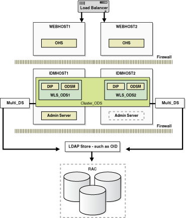

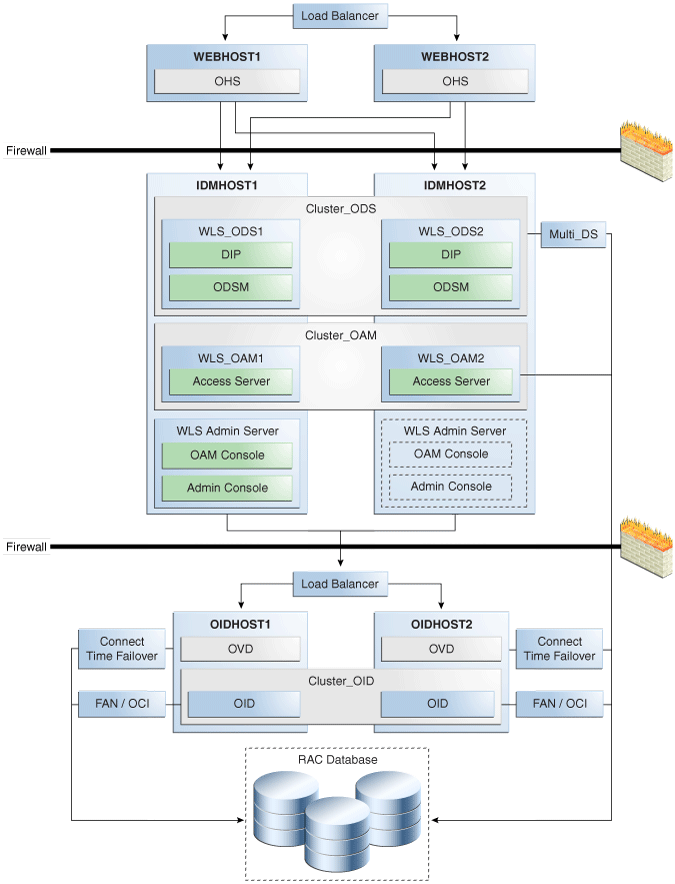

Figure 8-1 shows a sample Oracle Identity Management high availability architecture. This architecture includes a web tier, application tier, and directory tier.
Figure 8-1 Oracle Fusion Middleware 11g Oracle Identity Management High Availability Architecture
In Figure 8-1, the web tier includes the WEBHOST1 and WEBHOST2 computers.
Separate Oracle HTTP Server instances are installed on WEBHOST1 and on WEBHOST2. A load balancing router routes requests to Oracle HTTP Server instances on WEBHOST1 and WEBHOST2.

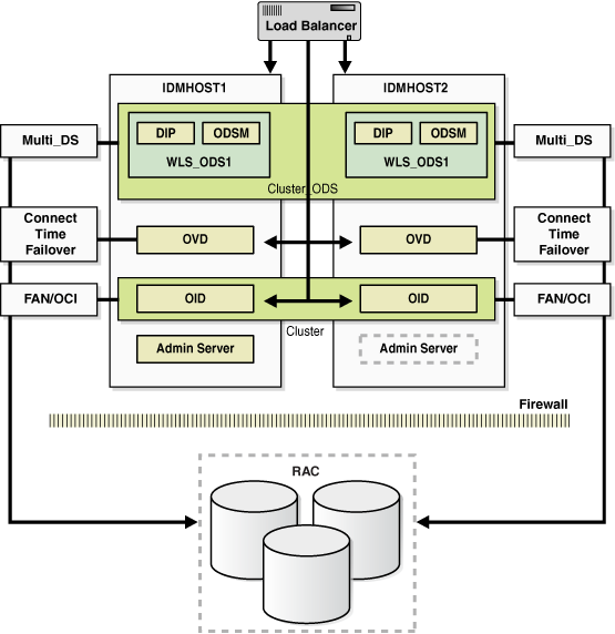

The application tier includes IDMHOST1 and IDMHOST2 computers.
On IDMHOST1, the following installations have been performed:
An Oracle Directory Services Manager instance and an ODIP instance are installed in the WLS_ODS1 Managed Server. Quartz Scheduler contacts Oracle RAC database through a JDBC multi data source to protect the instances from Oracle RAC node failures.
An Oracle Access Manager Access Server instance is installed in the WLS_OAM1 Managed Server.
An Administration Server is installed. Under normal operations, this is the active Administration Server. The Administration Server is a singleton application. The Oracle Access Manager Console is also installed as a singleton application.
On IDMHOST2, the following installations have been performed:
An Oracle Directory Services Manager instance and an ODIP instance are installed in the WLS_ODS2 Managed Server. The Oracle RAC database is configured in a JDBC multi data source to protect instances from Oracle RAC node failure.
The instances in the WLS_ODS2 Managed Server on IDMHOST2 and the instances in the WLS_ODS1 Managed Server on IDMHOST1 are configured as the Cluster_ODS cluster.
An Oracle Access Manager Access Server instance has been installed in the WLS_OAM2 Managed Server.
The Access Server instance in the WLS_OAM2 Managed Server on IDMHOST2 and the Access Server instance in the WLS_OAM1 Managed Server on IDMHOST1 are configured as the Cluster_OAM cluster.
A WebLogic Administration Server has been installed. Under normal operations, this is the passive Administration Server. You will make this Administration Server active if the Administration Server on IDMHOST1 becomes unavailable. See Chapter 12, "Active-Passive Topologies for Oracle Fusion Middleware High Availability" for information about active-passive configurations. The Oracle Access Manager Console is also installed as a singleton application and is passive until the Administration Server on IDMHOST2 becomes active.

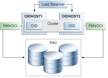

The directory tier includes OIDHOST1 and OIDHOST2. On both, an Oracle Internet Directory instance and an Oracle Virtual Directory instance are installed. Transparent Application Failover (TAF) connects the Oracle Internet Directory instance with the Oracle RAC database that serves as the security metadata repository. The database is enabled for server-side TAF and HA Events Notification.
The Oracle Internet Directory instances on OIDHOST1 and OIDHOST2 are configured as a cluster.
An Oracle Real Applications Cluster (Oracle RAC) database serves as the security metadata repository.

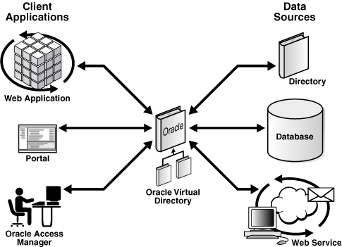

Oracle Virtual Directory |
LDAP Version 3-enabled service. Provides an abstracted view of one or more enterprise data sources. Oracle Virtual Directory consolidates multiple data sources into a single directory view, enabling you to integrate LDAP-aware applications with diverse directory server data stores. |

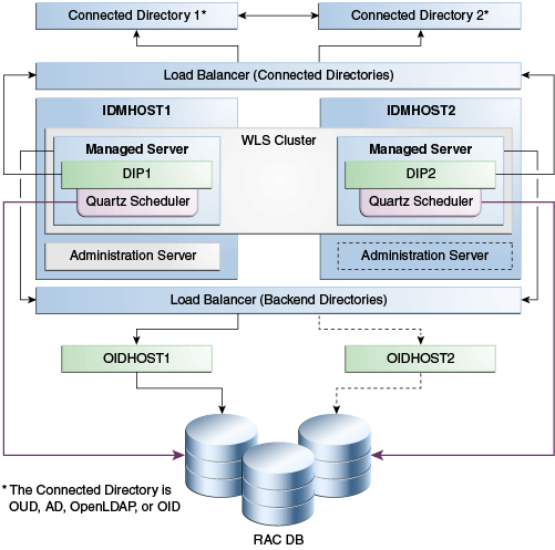

Oracle Directory Integration Platform |
The ODIP is a J2EE application that enables you to synchronize data between various directories and the back-end directory. ODIP includes services and interfaces that enable you to deploy synchronization solutions with other enterprise repositories. |

Figure 8-2 shows the Oracle Internet Directory Cluster Configuration high availability architecture in an active-active configuration.
Figure 8-2 Oracle Internet Directory Cluster Configuration High Availability Architecture
Figure 8-2 shows Oracle Internet Directory (OID) in the directory tier in a Cluster Configuration high availability architecture. Clustering is set up at installation time. The load balancing router routes LDAP client requests to the two OID instances that are clustered on OIDHOST1 and OIDHOST2.
Transparent Application Failover (TAF) is used to connect the OID instances with the Oracle RAC database that serves as the security metadata repository. The Oracle RAC database is configured in TNSNAMES.ORA. High availability event notification is used for notification when an Oracle RAC instance becomes unavailable. See Section 5.1.7.1, "Oracle Internet Directory" for more information about using OID with Oracle RAC.
In the Cluster Configuration, OPMN commands start each OID instance. There is no affect on OID at startup. A new database connection spawns when OID starts.
When the cluster is stopped using OPMN, OID disconnects from the database and the OID server stops.
Configuration changes can be done at a cluster level to any instance in the Cluster Configuration. All the nodes in the Cluster Configuration that share the same database read the same configuration information. The OIDMON process polls for configuration changes on each OID server and updates the database repository about configuration changes. OIDMON and other OID servers pull the changes from the database repository. In this way, any change made at a cluster member level is propagated to every OID server in the cluster.
The instance-specific configuration attributes for an OID LDAP server configuration are stored in this LDAP entry:
cn=<component-name>,cn=osdldapd,cn=subconfigsubentry
Oracle Internet Directory server configuration aspects such as the number of servers, database connections, sizelimit, and timelimit are part of the instance-specific server configuration entry.
The configuration attributes that are common to all OID instances in a cluster are stored in the LDAP entry:
cn=dsaconfig,cn=configsets,cn=oracle internet directory
To retain instance-specific server configuration attributes for each OID instance in the cluster, choose a distinct OID component name for each OID instance at install/configuration time; for example, oid1 on node1 and oid2 on node2. In this case, the configuration entries will be cn=oid1,cn=osdldapd,cn=subconfigsubentry and cn=oid2,cn=osdldapd,cn=subconfigsubentry respectively and they need to be updated separately for each OID instance.
If you choose to have a common set of server configuration attributes for both OID instances in the cluster, then you should choose the same OID component name for both OID instances, for example, oid1 on both OID node1 and node2. In this case, there will be one common configuration entry cn=oid1,cn=osdldapd,cn=subconfigsubentry.
Oracle Internet Directory LDAP server instances cache certain LDAP metadata artifacts such as Schema, ACLs, and Password Policy. Multiple OID LDAP server processes on a given node keep their caches in sync via semantics built around a shared memory segment managed by OID on each node. OIDMON keeps these caches in sync across nodes by ensuring that these shared memory segments are in sync across the nodes, which is achieved using the OID database.
Oracle Internet Directory also caches metadata and metadata changes trigger notification across the nodes. The ldapmodify utility is used to change metadata. The OID server that gets the ldapmodify request for the metadata change notifies other OID servers about the change of metadata (including OIDMON). OIDMON is responsible for notifying OIDMON on other nodes about the metadata changes.

When you deploy OID in a high availability configuration, Oracle recommends using an external load balancer to front-end OID instances and load balance requests between the OID instances. See Section 8.2.5.4, "Configuring Virtual Server Names and Ports for the Load Balancer" for details.
You can deploy Oracle Internet Directory in a highly availability configuration either in a standalone mode or as a part of a WebLogic Server domain.
Choose the standalone mode for deployments where OID is managed entirely using command line tools, and where Oracle Enterprise Manager Fusion Middleware Control and Oracle Directory Services Manager are not mandatory. Later, you can register standalone OID instances with a remote domain using opmnctl commands.
Oracle recommends that you set up OID in a clustered deployment in which clustered OID instances access the same Oracle RAC database repository.
This section includes the following topics:

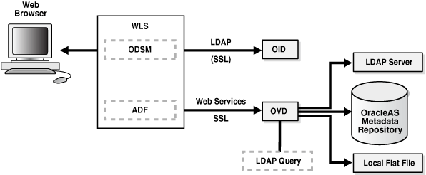

Oracle Virtual Directory is an LDAP version 3 enabled service that provides virtualized abstraction of one or more enterprise data sources into a single directory view. Oracle Virtual Directory provides the ability to integrate LDAP-aware applications into diverse directory environments while minimizing or eliminating the need to change either the infrastructure or the applications. Oracle Virtual Directory supports a diverse set of clients, such as Web Applications and portals, and it can connect to directories, databases and Web Services as shown in Figure 8-3.

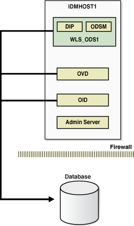

Figure 8-3 shows Oracle Virtual Directory in a non-high availability architecture.
Figure 8-3 Oracle Virtual Directory in a Non-High Availability Architecture
The Oracle Virtual Directory server is written in Java and internally it is organized into multiple layers. These layers are logical layers—Oracle Virtual Directory appears as a single complete service to the administrator and to clients.
OPMN is used to start, monitor, and manage the Oracle Virtual Directory process, and to restart the Oracle Virtual Directory process if it goes down. You can also use the Oracle Enterprise Manager Fusion Middleware Control to start and stop Oracle Virtual Directory instances. For more information on using OPMNCTL or Enterprise Manager to start and stop Oracle Virtual Directory instances, see Oracle Fusion Middleware Administrator's Guide for Oracle Virtual Directory.
Except for JPS, which is installed when Oracle Virtual Directory is installed, Oracle Virtual Directory does not have external dependencies. It can run by itself.
Oracle Virtual Directory can be configured to store LDAP objects in the local file system. This feature can be used by JPS and other components.
Oracle Virtual Directory has two types of listeners: LDAP and HTTP. Both listeners support SSL/TLS on top of their basic protocols. The LDAP layer also provides the ability to support LDAP-SASL to support digital certificate authentication.
The LDAP(S) protocols provide LDAPv2/v3 based services, and the HTTP(S) protocols provide one or more services such as DSMLv2, or basic white page functions provided by an XSLT enabled Web Gateway.
Based on the nature of the operation, client connections can be persistent or short-lived.

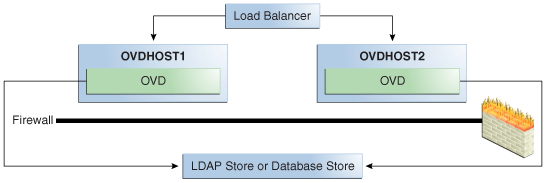

Figure 8-4 shows the Oracle Virtual Directory high availability architecture in an active-active configuration.
Figure 8-4 Oracle Virtual Directory in a High Availability Environment
The two-node cluster is set up at installation time. The load balancing router routes requests to the two Oracle Virtual Directory instances that are clustered on OVDHOST1 and OVDHOST2. Fast Connection Failover (FCF) is used for notification when an Oracle RAC instance becomes unavailable.
The two computers have the same Oracle Virtual Directory configuration. The Oracle Virtual Directory configuration for each instance is stored in its ORACLE_INSTANCE. Each Oracle Virtual Directory Instance configuration must be updated separately by using Oracle Directory Services Manager to connect to each Oracle Virtual Directory instance one at a time. The alternate approach is to update the configuration of one Oracle Virtual Directory instance and then use cloning to copy the configuration to the other Oracle Virtual Directory instance or instances.
Oracle Directory Services Manager should be used to manage Oracle Virtual Directory configuration. Oracle Directory Services Manager should not connect to Oracle Virtual Directory through the load balancer to perform configuration updates to an Oracle Virtual Directory instance; instead, it should connect explicitly to a physical Oracle Virtual Directory instance to perform a configuration update for that instance.
OPMN is used to start and stop Oracle Virtual Directory instances. When a cluster that includes multiple Oracle Virtual Directory instances is started, there is no impact on the individual Oracle Virtual Directory instances in the cluster.
The load balancing router detects a hang or failure of an Oracle Virtual Directory instance and routes LDAP and HTTP traffic to surviving instances. When the instance becomes available again, the load balancing router detects this and routes traffic to all the surviving instances.
If an instance fails in the middle of a transaction, the transaction is not committed to the back end.
If one Oracle Virtual Directory instance in the two-node Oracle Virtual Directory cluster fails, the load balancing router detects this and reroutes the LDAP client traffic to the surviving instance or instances in the cluster. When the Oracle Virtual Directory instance comes up again, the load balancing router detects this and reroutes the LDAP client traffic instance to the surviving instance or instances in the cluster.

Oracle Virtual Directory can be configured to use either an Oracle RAC database repository or a highly available LDAP repository as a data source.
This section describes how to configure Oracle Virtual Directory in a high availability environment with an Oracle RAC database repository and with an LDAP repository.
When configuring Oracle Virtual Directory in a high availability topology, the configuration steps must be completed on all the nodes individually.
In an Oracle Virtual Directory high availability environment with an Oracle RAC database as the repository, you must create and configure an Oracle Virtual Directory Database Adapter.
For more information about Oracle Virtual Directory Adaptors, see "Understanding Oracle Virtual Directory Adapters" in Oracle Fusion Middleware Administrator's Guide for Oracle Virtual Directory.
For information about creating Database Adapters for Oracle RAC databases, see "Creating Database Adapters for RAC Databases" in Oracle Fusion Middleware Administrator's Guide for Oracle Virtual Directory.
For information about configuring Database Adapters, see "Configuring Database Adapters" in Oracle Fusion Middleware Administrator's Guide for Oracle Virtual Directory.
Oracle Virtual Directory connects to a LDAP repository, such as Oracle Internet Directory, through an LDAP adapter. For high availability environments, the LDAP adapter can be configured by adding the host and port information of the nodes with a load balancing algorithm or by adding the load balancer URL of the LDAP repository.
For introductory information about Oracle Virtual Directory Adaptors, see the "Understanding Oracle Virtual Directory Adapters" section in Oracle Fusion Middleware Administrator's Guide for Oracle Virtual Directory.
For information about creating and configuring LDAP Adapters, see the "Configuring LDAP Adapters" section in Oracle Fusion Middleware Administrator's Guide for Oracle Virtual Directory.
Oracle Virtual Directory instances are front-ended by a hardware load balancer in high availability deployments. Requests are load balanced between the Oracle Virtual Directory instances, and in case of a failure (either an instance failure or a host failure), the hardware load balancer detects the failure and routes all requests to the surviving instance or instances.

This section describes ODIP in a typical high availability deployment.
Figure 8-5 shows ODIP with an OID backend in a high availability architecture.
Figure 8-5 Oracle Directory Integration Platform, with OID backend, in a High Availability Architecture
In Figure 8-5, Connected Directory 1 and Connected Directory 2 replicate information with each other. A load balancing router routes requests to the Connected Directories.
The Application Tier includes the IDMHOST1 and IDMHOST2 computers.
DIP1 and DIP2 go through the load balancer when they must communicate with the Connected Directories.
On IDMHOST1, the following installations are performed:
An ODIP instance is installed (DIP1) on the Managed Server.
A Quartz Scheduler is installed with DIP1 by default. It connects to the Oracle RAC database using a WebLogic multi data source. The Quartz Scheduler invokes EJBs that do the actual work; if the EJB fails, the Quartz Scheduler marks the job as failed and reschedules it to run at later time by another EJB.
On IDMHOST2, the following installations are performed:
An ODIP instance is installed (DIP2) on the Managed Server.
A Quartz Scheduler is installed on DIP2. Quartz Scheduler connects to the Oracle RAC database using a WebLogic multi data source.
An Administration Server is installed. Under normal operations, this is the passive Administration Server instance. You make this Administration Server active if the Administration Server on IDMHOST1 becomes unavailable.
The ODIP instances on the IDMHOST1 and IDMHOST2 Managed Servers are configured as a cluster.
A load balancer is set up for the back-end directories OIDHOST1 and OIDHOST2. The load balancer routes requests to either OIDHOST1 or OIDHOST2.
When you use a RAC database, multi data source is used with DIP to protect the instances from RAC failure.
By default, the WebLogic Server starts, stops, and monitors the applications and ODIP leverages the high availability features of the underlying clusters. If there is a hardware or other failure, session state is available to other cluster nodes that can resume the work of the failed node.
Node Manager monitors the WebLogic servers. If failure occurs, Node Manager restarts the WebLogic Server.
See "General Node Manager Configuration" in Oracle Fusion Middleware Node Manager Administrator's Guide for Oracle WebLogic Server for more information on Node Manager.
When you deploy Oracle Internet Directory (OID) in a high availability configuration, all OID instances in the cluster share the same database. Any changes made to ODIP on one OID node automatically propagate to all the Oracle Internet Directory instances in the cluster.

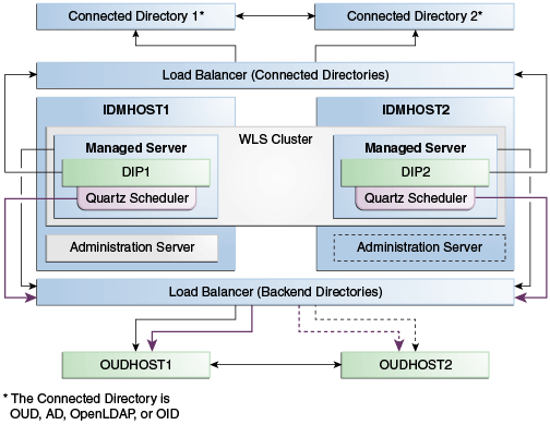

This section describes the ODIP High Availability Architecture with an OUD backend.
Figure 8-6 ODIP, with OUD backend, in a High Availability Architecture
In Figure 8-6, Connected Directory 1 and Connected Directory 2 replicate information with each other. A load balancing router routes requests to the Connected Directories.
An ODIP instance is installed (DIP1) on the Managed Server. DIP1 goes through the load balancer for connected directories when it must connect to them.
The Quartz Scheduler is installed. It goes through the load balancer for backend directories.
An ODIP instance is installed (DIP2) on the Managed Server. DIP2 goes through the load balancer for connected directories when it must connect to them.
A load balancer is set up for the back-end directories OUDHOST1 and OUDHOST2. The load balancer routes requests to either OUDHOST1 or OUDHOST2.

To configure ODIP and Oracle Directory Services Manager on IDMHOST2:
Ensure that the system, patch, kernel and other requirements are met. See the Oracle Fusion Middleware Installation Guide for Oracle Identity Management for the platform and version you are using.
Ensure that Oracle Identity Management software is installed and upgraded on IDMHOST2. See Section 8.3.3.1, "Installing Oracle Fusion Middleware Components."
Start the Configuration Wizard from the ORACLE_HOME/bin directory:
On UNIX, issue this command: ./config.sh
On Windows, double-click config.exe
On the Welcome screen, click Next.
On the Select Installation Type screen, select Install & Configure then click Next.
On the Prerequisite Checks screen, the installer completes the prerequisite checks. If any fail, please fix them and restart your installation.
Click Next.
On the Select Domain screen, select the Expand Cluster option and specify the values shown in the example below:
HostName: idmhost1.example.com
Port: 7001
UserName: weblogic
User Password: password for the weblogic user
Click Next.
The Administration Server runs on IDMHOST1.
On the Specify Installation Location screen, specify the following values:
Oracle Middleware Home Location: Prefilled and cannot be changed.
/u01/app/oracle/product/fmw
Oracle Home Directory: Prefilled and cannot be changed.
ods
WebLogic Server Directory:
/u01/app/oracle/product/fmw/wlserver_10.3
Oracle Instance Location:
/u01/app/oracle/admin/ods_instance2
Oracle Instance Name:
ods_instance2
Click Next.
On the Configure Components screen, de-select all products except Oracle DIP and Management Components.
Click Next.
On the Configure Ports screen, select Specify Ports Using Configuration File and enter the full path name to the staticports.ini file that you edited in the temporary directory.
Click Next.
On the Installation Summary screen, review the choices you made. If you must make any changes, click Back. If you made the correct selections, click Install.
On the Installation Progress screen, view the progress of the installation.
On UNIX systems, the oracleRoot.sh confirmation dialog box opens.
Leave the confirmation dialog box open, open another shell window, log in as root, and run this script file:
/u01/app/oracle/product/fmw/ods/oracleRoot.sh
On the Configuration Progress screen, view the progress of the configuration.
On the Installation Complete screen, click Finish.
In Section 8.5.3.1.3, the installer created a second Managed Server, wls_ods2, on IDMHOST2. However, the ODIP application is not deployed on IDMHOST2 and the newly-created Managed Server is not automatically started. Also, the WebLogic Administration Console shows the state of the wls_ods2 Managed Server on IDMHOST2 as UNKNOWN.
Follow these post-installation steps to complete the installation and configuration of the ODIP and Oracle Directory Services Manager applications on IDMHOST2.
To copy the ODIP application directly from IDMHOST1 to IDMHOST2:
Copy the following directory on IDMHOST1:
ORACLE_HOME/user_projects/domains/IDMDomain/config/fmwconfig/servers/wls_ods1
To the following location on IDMHOST2:
ORACLE_HOME/user_projects/domains/IDMDomain/config/fmwconfig/servers/wls_ods2
See the "Starting and Stopping Oracle Fusion Middleware" chapter of the Oracle Fusion Middleware Administrator's Guide for information on starting and stopping WebLogic Servers.
To restart the newly-created wls_ods2 Managed Server in a cluster on IDMHOST2:
Use this URL to access the Administration Console:
http://idmhost1.example.com:7001/console
Log into the console using the administrator's credentials.
In the left pane, expand Environment and select Clusters.
Click on the link for the cluster (cluster_ods) containing the Managed Server (wls_ods2) you want to stop.
Select Control.
Under Managed Server Instances in this Cluster, select the check box next to the Managed Server (wls_ods2) you want to start and click Start.
On the Cluster Life Cycle Assistant page, click Yes to confirm.
Node Manager starts the server on the target machine. When the Node Manager finishes its start sequence, the server's state is indicated in the State column in the Servers status table. The state should be RUNNING.
This topic describes how to configure Oracle Directory Integration Platform (ODIP) with OUD as the backend server.
To configure ODIP and OUD high availability, follow these steps:
Section 8.5.3.2.1, "Configuring Oracle Directory Integration Platform on IDMHOST1 (OUD)"
Section 8.5.3.2.2, "Creating boot.properties for the Administration Server on IDMHOST1"
Section 8.5.3.2.4, "Configuring Oracle Directory Integration Platform on IDMHOST2 (OUD)"

This topic describes how to register the OUD back-end directory with ODIP. You run the dipConfigurator command on both hosts to register the directory. The dipConfigurator command performs the following steps:
Loads the schema that ODIP requires into OUD
Loads the ODIP content in cn=oraclecontext suffix
Creates an ODIP user
Applies specific ACIs for the ODIP user
To register OUD back-end directories with ODIP:
On IDMHOST1, run the following:
cd ORACLE_HOME/bin
./dipConfigurator setup -wlshost IDMHOST1 -wlsport 7001 -wlsuser weblogic -ldaphost OUDHOST1 -ldapport OUD_LDAP_PORT1 -ldapuser "cn=Directory Manager" -ldapadminport OUD_LDAP_ADMIN_PORT1 -isldapssl false -isclustered true
./dipConfigurator setupSecondaryBackend -ldaphost OUDHOST2 -ldapport OUD_LDAP_PORT2 -ldapuser "cn=Directory Manager" -ldapadminport OUD_LDAP_ADMIN_PORT2 -isldapssl false
Tune the cluster with the command manageDIPServerConfig:
./manageDIPServerConfig set -host IDMHOST1 -port 7005 -wlsuser weblogic -attribute ClusterCheckInInterval -value 30000 ./manageDIPServerConfig set -host IDMHOST1 -port 7005 -wlsuser weblogic -attribute RefreshInterval -value 120
Reconfigure ODIP to use the TCP load balancer.
LB_HOST is the load balancer IP address you must configure to redirect to one of the backend instances.
./manageDIPServerConfig set -host IDMHOST1 -port 7005 -wlsuser weblogic -attribute BackendHostPort -value LB_HOST:LB_PORT

Oracle recommends configuring the load balancer to support failover mode compared to round robin or other modes. The load balancer must support long-lasting LDAP connections so that ODIP can process long batches of data. It is not unusual for ODIP to keep connections open longer than 10 minutes.
Oracle Directory Integration Platform (ODIP) uses readers to retrieve changes from connected directories. However, there are some connectors that you cannot use for load-balanced directories. This section describes how ODIP supports the use of several instances of a connected directory for import profiles.
ODIP does not support transparent failover from one Oracle Directory Server Enterprise Edition (ODSEE) Managed Server (WLS_ODSEE1) to another ODSEE server (WLS_ODSEE2). Even if you replicate ODSEE Managed Server instances, the change numbers may not be identical on both ODSEE Managed Servers for the same update. If ODIP fails over transparently from WLS_ODSEE1 to WLS_ODSEE2, ODIP may replay changes or miss changes each time it switches.
To manually failover an ODSEE Managed Server, see "Directory Synchronization Profiles."
When you use OUD with Iplanet Reader and Iplanet Writer, OUD does not support transparent failover from one OUD instance to another because, as with ODSEE Server, change numbers may not be synchronized. However, you can configure your profile to use an OUD connector that does support it.
To configure your profile, you must set the reader to oracle.ldap.odip.gsi.OudCookieReader. You must configure this attribute at creation time; you cannot configure it for existing profiles.
To configure your profile:
Go to the directory ORACLE_HOME/ldap/odi/conf and edit the file iplanetimp.cfg.master
Replace the line: Reader: oracle.ldap.odip.gsi.IPlanetReader with the line oracle.ldap.odip.gsi.OudCookieReader
To failover transparently from one OUD instance to another, the reader uses the External Change Log cookie that OUD provides. The last applied change number contains a cookie but no longer contains a change number.
See "Using the External Change Log" in the Oracle Fusion Middleware Administrator's Guide for Oracle Unified Directory for more information on OUD external change log cookies.
Oracle Directory Integration Platform offers two ways to synchronize with Microsoft Active Directory: the USNChanged approach and the DirSync approach. Only the DirSync approach permits transparent failover from one instance to the other.
See "Synchronizing from Microsoft Active Directory to the Oracle Back-end Directory" in the guide Oracle Fusion Middleware Administrator's Guide for Oracle Directory Integration Platform.
Because the ODIP reader for Novell eDirectory is based on timestamps, clocks on all instances must be synchronized.
Because ODIP reader for OpenLDAP is based on timestamps, clocks on all instances must be synchronized.
Oracle does not support Tivoli by means of the load balancer.
If you configure Oracle Internet Directory (OID) replication so that change numbers are identical on all OID instances that you target, the OID instances can failover transparently. If you do not set up this configuration, transparent failover is not supported.
In a high availability environment, you deploy the ODIP application on a WebLogic Server cluster that comprises at least two WebLogic instances.
By default, the ODIP application leverages high availability features of the underlying WebLogic clusters. In case of hardware or other failures, session state is available to other cluster nodes that can resume the work of the failed node.
In addition, in a high availability environment, Node Manager is configured to monitor the WebLogic servers. In case of failure, Node Manager restarts the WebLogic Server.
If an instance of OID fails, the load balancer redirects to the surviving instance of OID and the Oracle RAC database. If OUD fails, the load balancer redirects to the surviving instance of OUD.
In case of a database instance failure, the surviving Oracle RAC node takes over any remaining processes. There may be innocuous errors in the Managed Servers logs during an Oracle RAC failover; see Section 8.5.6, "Troubleshooting Oracle Directory Integration Platform High Availability."

Figure 8-7 shows the Oracle Directory Services Manager architecture.
Figure 8-7 Oracle Directory Services Manager Architecture
Figure 8-7 shows Oracle Directory Services Manager deployed in non-high availability architecture. Oracle Directory Services Manager is deployed on the Oracle WebLogic Server. Oracle Directory Services Manager is configured to communicate with the Oracle Virtual Directory and the Oracle Internet Directory instances it manages.
Oracle Directory Services Manager uses the HTTP(s) protocol to communicate with client browsers. It uses the LDAP(s) protocol to communicate with Oracle Internet Directory and over web services to communicate with Oracle Virtual Directory.
Oracle Directory Services Manager is an Oracle Application Development Framework (ADF)-based J2EE application that is deployed on top of the Oracle WebLogic Server.
Oracle Directory Services Manager can be deployed on the same node with Oracle Internet Directory or on a separate node.
Oracle Directory Services Manager can be invoked directly or from Oracle Enterprise Manager Fusion Middleware Control.

In the Oracle Directory Services Manager high availability configuration described in this section, Oracle Directory Services Manager and ODIP are installed and configured on two hosts in a two-node high availability active-active configuration.
Figure 8-8 shows the ODIP and Oracle Directory Services Manager high availability architecture in an active-active configuration.
Figure 8-8 Oracle Directory Services Manager and Oracle Directory Integration Platform in a High Availability Architecture
In Figure 8-8, the application tier includes the IDMHOST1 and IDMHOST2 computers.
An ODIP instance and Oracle Directory Services Manager instance are installed on the WLS_ODS1 Managed Server. The Oracle RAC database is configured in a JDBC multi data source to protect the instances from Oracle RAC node failure.
A WebLogic Administration Server is installed. Under normal operations, this is the active Administration Server.
An ODIP instance and Oracle Directory Services Manager instance are installed in the WLS_ODS2 Managed Server. The Oracle RAC database has been configured in a JDBC multi data source to protect the instances from Oracle RAC node failure.
The instances in the WLS_ODS2 Managed Server on IDMHOST2 and the instances in the WLS_ODS1 Managed Server on IDMHOST1 are configured as the CLUSTER_ODS cluster.
In a high availability architecture, ODIP and Oracle Directory Services Manager are deployed on an Oracle WebLogic Cluster that has at least two servers as a part of the cluster.
By default, the WebLogic Server starts, stops and monitors the applications. By default, both the ODIP and Oracle Directory Services Manager applications leverage the high availability features of the underlying WebLogic Clusters. In case of hardware or other failures, session state is available to other cluster nodes that can resume the work of the failed node.
In a high availability environment, Node Manager is configured to monitor WebLogic servers. In case of failure, Node Manager restarts the WebLogic Server. If Node Manager cannot restart the server, then the front-ending load balancing router detects failure of a WebLogic instance in the Cluster and routes traffic to surviving instances.

Figure 8-9 shows Oracle Internet Directory, ODIP, Oracle Virtual Directory, and Oracle Directory Services Manager collocated on a single host and deployed in a non-high availability architecture.
Figure 8-9 Collocated Components Architecture
All the components in Figure 8-9 are deployed on the same host, but have separate Oracle homes and Oracle instances. Oracle Internet Directory uses a standalone Oracle database as the security metadata repository.
Figure 8-10 shows Oracle Internet Directory, Oracle Virtual Directory, ODIP, and Oracle Directory Services Manager collocated on IDMHOST1 and IDMHOST2 and deployed in a high availability architecture.
Figure 8-10 Collocated Components in a High Availability Architecture
