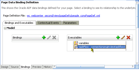

To access the Edit Task Flow Binding dialog:
  1. Open the application page and set the view to bindings by clicking the Bindings tab at the bottom of the page.
  2. Under Executables, double-click the task flow for which to revise task flow binding parameters (Figure 39-1) to open the Edit Task Flow Binding dialog (Figure 39-2).
    Tip:
    Task flow names under Executables differ from names in design view. For example, Message Board task flows are instead referred to as wall, and Feedback task flows are instead referred to as kudos.
    Figure 39-1 Bindings View of an Application Page
    Description of Figure 39-1 follows
    Description of ''Figure 39-1 Bindings View of an Application Page''

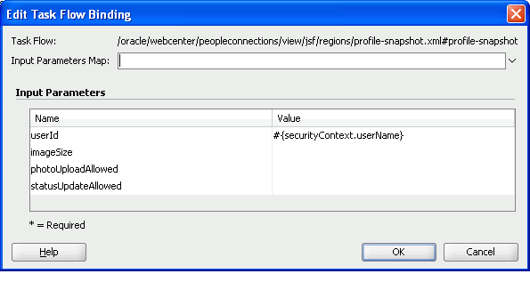

    Figure 39-2 Edit Task Flow Binding Dialog
    Description of Figure 39-2 follows
    Description of ''Figure 39-2 Edit Task Flow Binding Dialog''
  3. Revise binding parameter values (for more information, see Section 39.3, "People Connections Task Flow Binding Parameters").
  4. Click OK to save your changes and exit the dialog.
  5. Save and run your page to see the results.

imageSize
The display size of the profile photo
Enter one of the following values:
  • ORIGINAL
  • LARGE
  • MEDIUM
  • SMALL
This parameter is associated with the Profile - Snapshot task flow.
isUpdateStatus
A means of dedicating the task flow instance to updating the current user's Profile status message
Enter #{true} to devote the task flow instance to updating user status messages. Enter #{false} to omit publishing messages to the current user's Profile status message.
This parameter is associated with the Publisher task flow.
