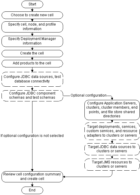

Figure 1-2 illustrates the workflow for creating a new cell. The steps indicated in boxes with dashed lines are relevant only when you create cells that contain specific products, such as those that use JDBC data sources or JMS resources.
Figure 1-2 Workflow for Creating a New IBM WebSphere ND Cell
