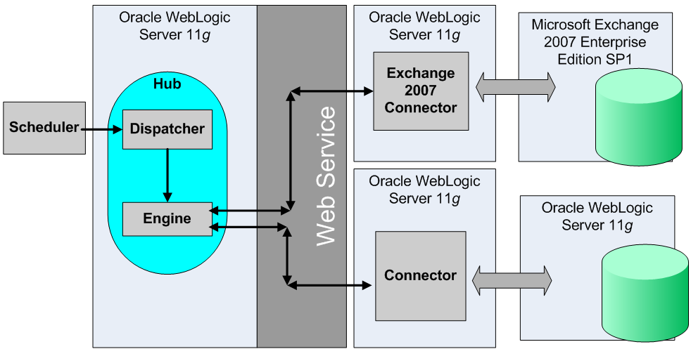

Although installing most of the components on separate application servers results in improved scalability support, you can install all of them on the same application server. However, installation on a single application server affects performance and port settings.
Figure 3-1 Basic Installation of BDSS
Basic installation

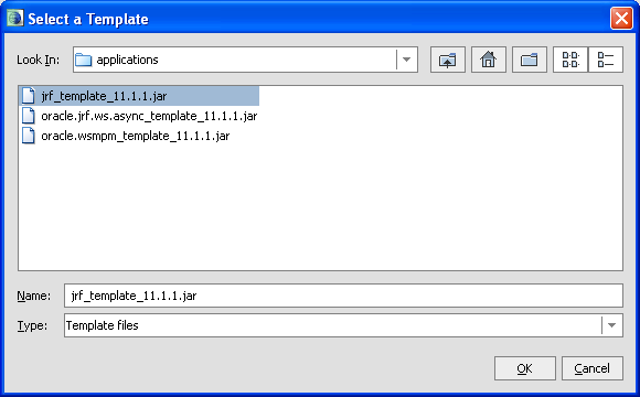

  3. Select the WebLogic Server domain and then click Next. The Select Extension Source screen appears.
  4. Select Extend my domain using an existing extension template.
  5. Using the browse function of the Template location field, navigate to, and then select <domain root>\jdeveloper\common\templates\applications\jrf_template_11.1.1.jar.
    Figure 3-2 Selecting the JRF Template
    Selecting the JRF template
  6. Click OK.

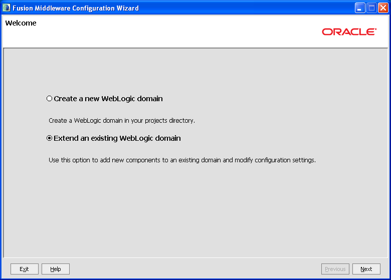

  1. Start Configuration Wizard and then select Extend an existing WebLogic Domain in the Welcome screen (Figure 3-3). Click Next. The Select a WebLogic Domain Directory screen appears.
    Figure 3-3 Extending the WebLogic Server Domain
    Extending the domain.

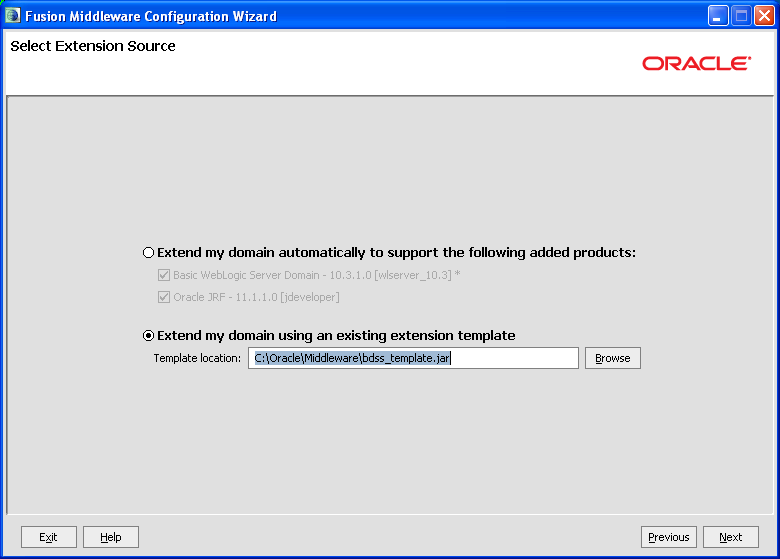

  2. Select any domain that has JMS installed and then click Next. The Select Extension Source screen appears.
  3. Select Extend my domain using an existing extension template.

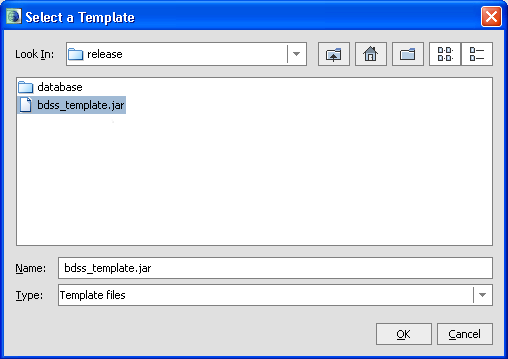

  4. Using the Select a Template dialog, locate bdss_template.jar (Figure 3-4) and then click OK.
    Figure 3-4 Selecting bdss_template.jar
    Select bdss_template.jar
  5. In the Select Extension Source dialog, select BDSS template.jar and then click Next.
    Figure 3-5 Selecting bdss_template.jar

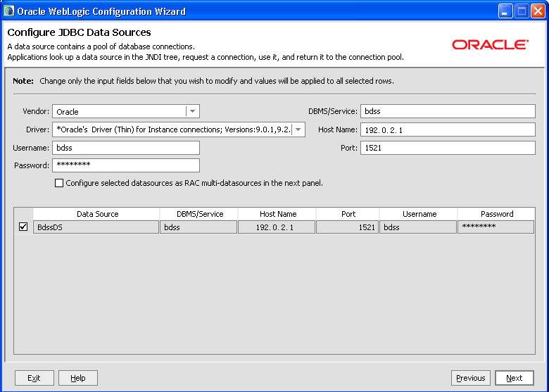

  6. In the Configure JDBC DataSource page (Figure 3-6), enter the connection information. The user name must be bdss. Click Next. The Test JDBC Data sources screen appears.
    Figure 3-6 Configuring the JDBC Data Source
    Selecting JDBC sources.

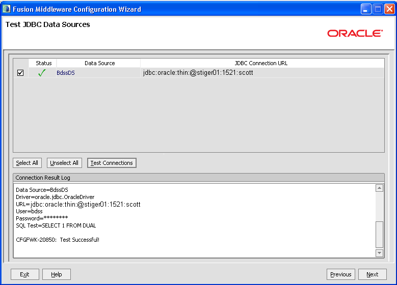

  7. Click Test Connections. Click Next after Configuration Wizard generates a Test Successful! message (Figure 3-7). The Run Database Scripts screen appears.
    Figure 3-7 Testing the JDBC Connections

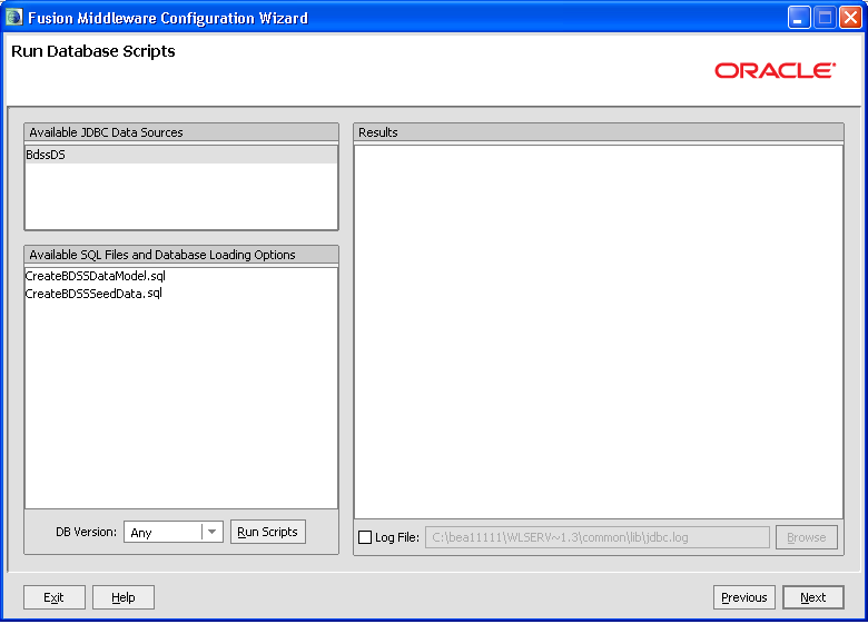

  8. In the Run Database Scripts page (Figure 3-8), click Run Scripts.The CreateBDSSDataModel.sql script creates the database tables and triggers and the BDSSSeedData.sql script populates the database with sample data for the domains.
    Figure 3-8 Creating the Database Tables and Seeding Data
    Select model and data scripts

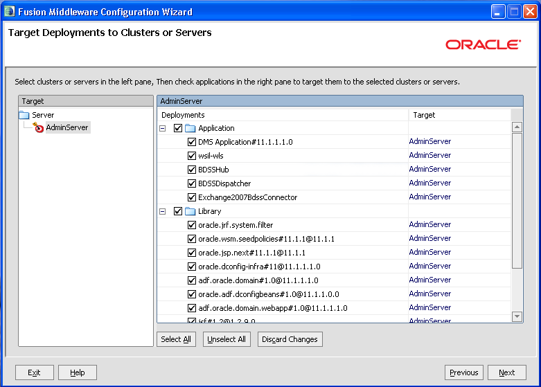

  9. Continue to the Target Deployments to Clusters and Servers screen (Figure 3-9).
    The Dispatcher, the Hub, and the Exchange 2007 Connector are deployed by default. If needed, select Deployments and Services in the Select Optional Configuration screen that follows the Run Database Scripts screen. After you select this option, you then select the applications to deploy. This optional configuration enables scalability by allowing you to deploy each component on a different WebLogic Server.
    Figure 3-9 Selecting BDSS Components
    Select BDSS components
  10. Select the BDSS components to deploy and then click Next. By default, the wizard deploys the Dispatcher, the Hub, and the Exchange 2007 Connector. The Configuration Summary screen appears (Figure 3-10).

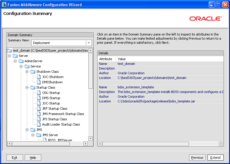

    Figure 3-10 The Configuration Summary Screen
  11. Review the installed components. Click Previous to return to the Target Deployments to Clusters or Services and change your selection.

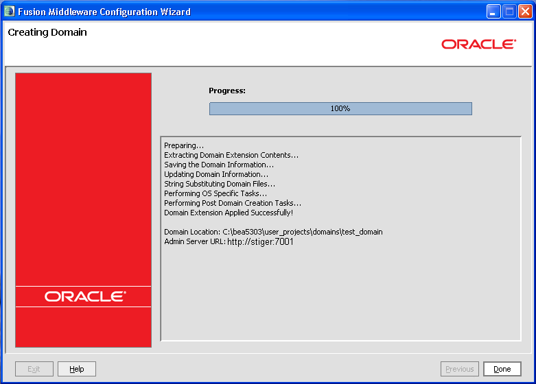

  12. Click Next. The Configuration Manager creates the domain. When the progress indicator on the Creating Domain screen completes (Figure 3-11). Click Done.
    Figure 3-11 The Create Domain Screen
    Completing the domain.

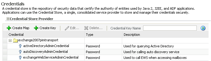

Add the credentials listed in Table 3-2 using Fusion Middleware Control, as illustrated in Figure 3-12.
Figure 3-12 Creating Credentials in Oracle Enterprise Manager
Add the JPS credentials
The following steps describe how you enter in the credentials using Oracle Enterprise Manager.
  1. Log in to Oracle Enterprise Manager.
  2. Expand the WebLogic Domain node in the navigation pane and then right-click your domain.
  3. From the context menu, select Security and then Credentials. The Security Page appears.
  4. Create the exchange2007pimtransport credential map by clicking Create Map. The Create Map dialog appears.
  5. Enter exchange2007pimtransport in the Map Name field and then click OK.
  6. For each JPS key listed in Table 3-2, perform the following:
    1. Click Create Key. The Create Key dialog appears.
    2. Select exchange2007pimtransport from the Select Map list.
    3. Enter the JPS key. For example, enter activeDirectoryAdminCredential.
    4. In the User Name field, enter in the user name (ensuring to prefix the domain if needed)
    5. In the Password field, enter the password.
  7. Click OK.
