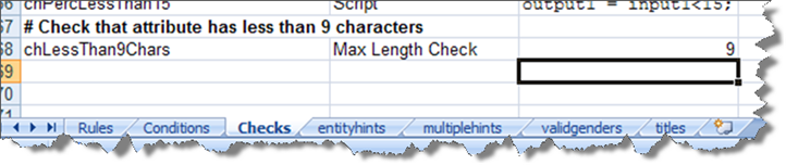

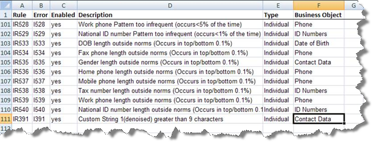

The Business Rules are set in two .xls files supplied with Data Quality Health Check, located in the oedq.home/business rules folder. To edit these .xls files, you must move them to oedq_local_home/business rules.
dq-health-check-business-rules-individual.xls - Individual Business Rules spreadsheet.
dq-health-check-business-rules-entity.xls - Entity Business Rules spreadsheet.
There is an additional spreadsheet - rulesreference.xls - in the oedq_local_home/landingarea/dqhealthcheck folder which has two main functions: it is used to control which rules in the Business Rules spreadsheets are used when running Data Quality processes, and also to construct rules statistics.
Note :
By default, the Individual and Entity rules that are used by EDQ-AV are enabled in therulesreference.xls spreadsheet. If EDQ-AV is not installed these rules must be disabled to prevent inaccurate reporting in the Dashboard.The Enabled column in the rulesreference.xls spreadsheet controls which rules are enabled and which are disabled, the two possible values being yes and no. Therefore, if any existing rules are edited or new rules added to the Business Rules spreadsheets, the changes must be reflected in the rulesreference.xls sheet. Any changes made must preserve the separation of rule types, which object (Individual or Entity) they relate to, and their associated rule and error codes.
The rules fall into the following categories:
Population checks – Check that a field is not blank. For example, ER205 - Check if Name is missing.
List checks - Check that the data contains only values from a specified list. For example, IR202 - Check if Upper Case gender is a valid value.
Length checks - Check that the data is of a specified length,. For example, IR203 - Check first name is > 1 char.
Format checks - Check that the data conforms to a pattern or regular expression. For example, IR212 - Check if email is valid format.
Contains checks - Check that the data contains a value from a list; for example IR428 - Check if full name is clear of entity hints.
Suspect data checks - Check that the data exhibits any common data entry "cheats". For example, ER411 - Check if unusual characters in name.
Value checks – Check that the field value is in the correct range. For example, IR430 - Check if DOB is very old (<1900).
Dependent attribute checks – Check that two attribute values are consistent, for example, if the value in one attribute is dependent on the value in another attribute. For example, IR302 - Check if gender and title are consistent.
Duplicate checks - Compare combinations of data attributes to estimate potential levels of record duplication. This is not full EDQ-CDS matching, and therefore is designed to run in a fraction of the time. Examples of comparisons include:
IR401 - Check if fname address1 are flagged dupe
IR403 - Check if fname email are flagged dupe
IR408 - Check if lname tax no are flagged dupe
For information on customizing existing and creating new Business Rules using these spreadsheets, see the "Defining Business Rules" topic in the Oracle Enterprise Data Quality Director Online Help.

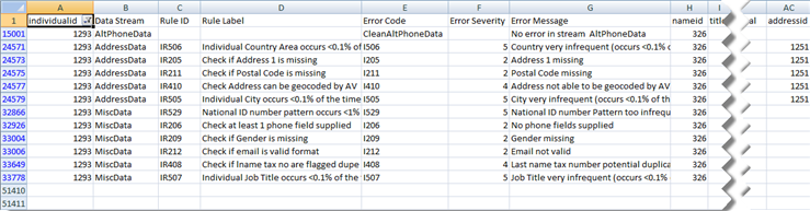

This setting controls whether the results of the Health Check jobs are published in the form of a .csv file for use in a BI tool:
phase.Export\ BI\ Data.enabled = no
The default value is no. Set to yes to publish the data to the .csv file.
Note :
The value must always be in lower case,yes or no.If export is enabled, these settings specify the destination of the exported file, the field separator and encoding. The default settings are included as in the following:
phase.*.Export.*.Entity_Output_CSV_File_Location = \\dqhealthcheck\\entityoutput.csv phase.*.Export.*.Entity_Output_CSV_File_Field_Separator = \, phase.*.Export.*.Entity_Output_CSV_File_Encoding = UTF-8 phase.*.Export.*.Individual_Output_CSV_File_Location = \\dqhealthcheck\\individualoutput.csv phase.*.Export.*.Individual_Output_CSV_File_Field_Separator = \, phase.*.Export.*.Individual_Output_CSV_File_Encoding = UTF-8
Note :
The encoding of the export file must be valid for EDQ delimited text Data Stores. A list of valid encoding formats can be found in the Edit Data Store dialog in EDQ.If EDQ-AV is installed, this setting should be assigned the ISO two-character country code to be used by default. For example, if the country code is not specified in the data supplied:

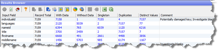

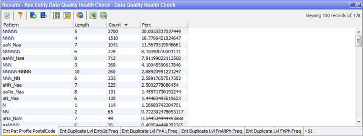

To create EDQ Results Books populated with Individual and/or Entity profiling data, uncomment the following settings.
Note :
The first six lines are for the Individual Profiling Results book, and the last two are for the Individual Rules Results book. It is possible to populate one or both of these books as required.For Individual data, these settings will populate the Individual Profiling Results Book with drillable results of all profilers and the Individual Rules Results Book with a drillable view of rule failures.
phase.Profile\ Individual\ Misc\ Data.enabled = no phase.Profile\ Individual\ Misc\ Data\ With\ Results\ Book.enabled = yes phase.Profile\ Individual\ Address\ Data.enabled = no phase.Profile\ Individual\ Address\ Data\ With\ Results\ Book.enabled = yes phase.Profile\ Individual\ Alt\ Phone Data.enabled = no phase.Profile\ Individual\ Alt\ Phone\ Data\ With\ Results\ Book.enabled = yes phase.Process\ Rule\ Failures\ to\ Outputs.enabled = no phase.Process\ Rule\ Failures\ to\ Outputs\ With\ Results\ Book.enabled = yes
For Entity data, these settings will populate the Entity Profiling Results Book with drillable results of all profilers and the Entity Rules Results Book with a drillable view of the rule failures:
phase.Profile\ Entity\ Misc\ Data.enabled = no phase.Profile\ Entity\ Misc\ Data\ With\ Results\ Book.enabled = yes phase.Profile\ Entity\ Address\ Data.enabled = no phase.Profile\ Entity\ Address\ Data\ With\ Results\ Book.enabled = yes phase.Profile\ Entity\ Alt\ Phone\ Data.enabled = no phase.Profile\ Entity\ Alt\ Phone\ Data\ With\ Results\ Book.enabled = yes phase.Make\ Analysis\ and\ Server\ Console\ Output.enabled = no phase.Make\ Analysis\ and\ Server\ Console\ Output\ With\ Results\ Book.enabled = yes

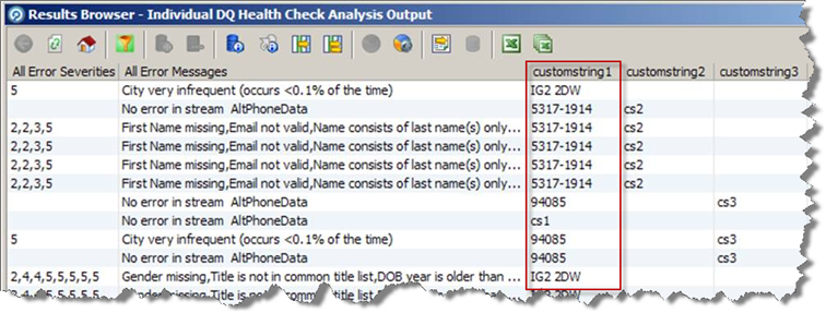

These settings control which Staged Data items are visible in Server Console.
The first setting - stageddata.*.visible = no - makes all Staged Data items invisible by default. The remaining settings then make specific Staged Data items visible.
By default, detailed data in the DQ Health Check Analysis Output tab in the Server Console Results screen is hidden. This is because the level of detail is seldom required for most purposes. To view this data, set the following properties in the Run Profile to yes:
stageddata.Individual\ DQ\ Health\ Check\ Analysis\ Output.visible =
stageddata.Entity\ DQ\ Health\ Check\ Analysis\ Output.visible =

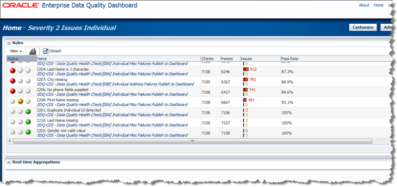

By default, the Health Check results are published to the Dashboard.

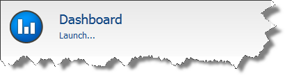

The Dashboard is accessed from the EDQ Launchpad:

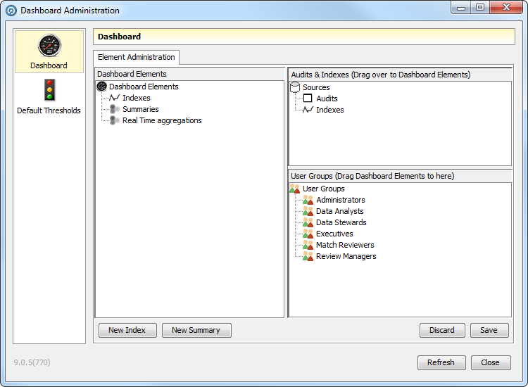

To configure Health Check results on the Dashboard, use the following procedure:

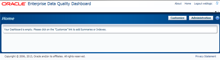

Open the Dashboard.
On the main Dashboard, click Administration.
The Dashboard Administration is displayed:
Create the Summaries and Indexes as required.
Note :
Any rules added to the Summaries should correspond with those enabled in therulesreference.xls spreadsheet. If a disabled rule is included in a Summary or Index it will always be red-flagged, regardless of the results of enabled rules.Return to the Dashboard and click Customize.

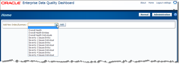

Select the Data Quality results to view in the Add New drop-down field. For example:
Click Add. The selected item is added to the Home view.
Once this configuration procedure is complete, it is possible to choose which Summaries and Indexes to add to the Initial view, to drill down into the results. For full details of how to do this, see Oracle Enterprise Data Quality Dashboard Online Help.

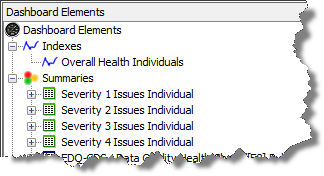

Then create the following Indexes:
| Name | Contents |
| Overall Health Individuals | Contains all the Individual Summaries. |
| Overall Health Entities | Contains all the Entity Summaries. |
| Overall Health | Contains the Individual and Entity Summaries. |
Open EDQ Dashboard, and click Administration to open the Dashboard Administration window.
Click New Summary.
Enter Severity 1 Issues Individual in the Add Summary pop-up.
Click OK. The new Summary is displayed in the Summaries node of the Dashboard Elements area.
In the Audits and Indexes area, expand the Audits branch, then expand the EDQ-CDS – Data Quality Health Check/[I8A] Individual Misc Failures Publish to Dashboard branch.
Click and drag I101 and I102 from the [I8A] Individual Misc Failures Publish to Dashboard audits list to the Severity 1 Issues Individual Summary.
Click and drag the Severity 1 Issues Individual Summary to the Administrators node in the User Group area.
Click Save.
Repeat for the remaining summaries.

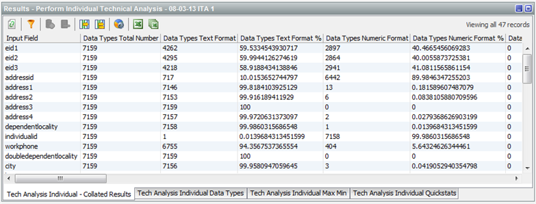

Perform Entity Technical Analysis
Perform Individual Technical Analysis

The following is a complex example. The record with individualid 1293 has returned 12 rows:
It has the following:
One altphone field, free of errors.
Five errors associated with one address.
Six errors associated with other fields in the record (for example, Misc Data.)
Note :
In the example file, theaddressid in each row is identical, which shows that only one address is associated with the record. The illustration does not show this because of the limit of the screen size.The results published to the Dashboard are dependent on the enabled Business Rules, see Section 4.6, "Managing Business Rules". The following Dashboard example illustrates the variations of results and statuses:

When run in Server Console, the Technical Analysis jobs profile the data by data type, maximum and minimum values and quick stats:
The Health Check jobs perform audit checks on the data and populate the EDQ Dashboard and BI .csv files depending on your run profile configuration.

The Technical Analysis jobs only use customer data and publish the analysis results to Server Console or in Results Books only.
It is possible to drill-down through these results for further analysis. Drillable results are links (highlighted in blue):

If required, open the Dashboard Administration application to add the rule to an appropriate Summary.

Start Server Console.
In the Results view, select a previous run of Health Check.
The DQ Health Check Analysis Output tab should be displayed at the bottom of the window by default. Scroll across to view the customstring1 column and check the format of the results. In the example image, the format is clearly incorrect: as one field contains a space and the other a hyphen it is not limited to alphanumeric data only:
Close Server Console.

Click the Checks tab.
Create a new entry for a check specifying a maximum length of nine characters.
Note :
The wording describes the check taking place. In order to fail entries of more than nine characters, the check performed is actually whether the entries are nine characters long or less.

Editing the rulesreference.xls Spreadsheet
Navigate to the oedq_local_home/landingarea/dqhealthcheck folder.
Open the rulesreference.xls file.
Click the Misc tab.
Add the details of the new rule to the bottom of the worksheet, as illustrated in following:
Click Save and close the spreadsheet.

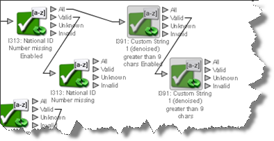

In Director, open the [I8A] Individual Misc Failures Publish to Dashboard process.
Make a copy of a group of two of the Audit processors. For the purposes of this example, copy the I313 Audit Processors.
Paste the copies onto the canvas to the right of the I313 Processors.
Rename both copied processors: I391: Custom String 1 (denoised) greater than 9 chars Enabled and I391: Custom String 1 (denoised) greater than 9 chars.
Connect the All output of the I313: National ID Number missing processor to the I391: Custom String 1 (denoised) greater than 9 chars Enabled processor. The processors should now appear as in the following:
Double-click the I391: Custom String 1 (denoised) greater than 9 chars Enabled processor.
In the Processor dialog, click the Options tab.
Set the Regular Expression field to I391 .
Click Save and close the dialog.
Repeat steps 7 to 9 for the I391: Custom String 1 (denoised) greater than 9 chars processor.
Click the Dashboard tab.
Set the Rule Name field to "I391: Custom String 1 (denoised) greater than 9 chars".
Save changes, and close the process.
Updating the Dashboard Summaries
Once the Individual Data Quality Health Check job has been run again, it is possible to add the new rule to the required Summary in the Dashboard Administration application.

These tables contain the rules to be included in the Summaries described in Section 4.4.2, "Example - Dashboard By Business Function."
Account - Name Details
| Audit Code | Description |
| E101 | Full Name missing |
| E202 | Name is 1 character |
| E205 | Name missing |
| E302 | Sub Name is 1 character |
| E303 | SubName missing |
| E408 | Name contains potential multiples hints |
| E409 | Sub Name contains potential multiples hints |
| E411 | Unusual characters in name |
| E412 | Unusual characters in subname |
Account - Identifiers
| E102 | Entity Id missing |
| E204 | No phone fields supplied |
| E304 | Tax Number missing |
| E305 | VAT Number missing |
| E306 | Website missing |
| E307 | Website not valid |
| E410 | Alternate phone is missing |
| E413 | Unusual characters in phone |
| E417 | Alternate phone is missing |
| E419 | Phone is missing |
Account - Identifier Outliers
| E420 | Alt Phone appears to have less than 2 digits present |
| E510 | Alt phone length outside norms (Occurs in top/bottom 0.1%) |
| E520 | Alt phone Pattern too infrequent (occurs<5% of the time) |
| E421 | Phone appears to have less than 2 digits present |
| E504 | Tax Number too frequent (occurs>5% of the time) |
| E505 | VAT Number too frequent (occurs>5% of the time) |
| E506 | Website too frequent (occurs>5% of the time) |
| E513 | Phone length outside norms (Occurs in top/bottom 0.1%) |
| E514 | Tax number length outside norms (Occurs in top/bottom 0.1%) |
| E515 | VAT number length outside norms (Occurs in top/bottom 0.1%) |
| E521 | Phone Pattern too infrequent (occurs<5% of the time) |
| E523 | Tax number Pattern too infrequent (occurs<1% of the time) |
| E524 | VAT number Pattern too infrequent (occurs<1% of the time) |
| E525 | Website Pattern too frequent (occurs>5% of the time) |
Account - Address Details
| E203 | Address 1 missing |
| E206 | Postal Code missing |
| E207 | City missing |
| E301 | Address not able to be verified by AV processor |
| E308 | Addresses 2 and 3 missing |
| E407 | Address not able to be geocoded by AV processor |
| E414 | Address 2 is missing |
| E415 | Address 3 is missing |
| E416 | Admin area is missing |
| E418 | Country is missing |
Account - Address Detail Outliers
| E501 | Admin Area very infrequent (occurs <0.1% of the time) |
| E502 | City very infrequent (occurs <0.1% of the time) |
| E503 | Country very infrequent (occurs <0.1% of the time) |
| E511 | City length outside norms (Occurs in top/bottom 0.1%) |
| E512 | Country length outside norms (Occurs in top/bottom 0.1%) |
| E522 | Postal code Pattern too infrequent (occurs<1% of the time) |
Account - Potential Duplicates
| E201 | Duplicate Entity Id detected |
| E401 | Full name address1 potential duplicate |
| E402 | Full name alt phone potential duplicate |
| E403 | Full name phone potential duplicate |
| E404 | Full name website potential duplicate |
| E405 | Name tax number potential duplicate |
| E406 | Name VAT number potential duplicate |
Contact - Name Details
| I101 | Full Name missing |
| I203 | First Name is 1 character |
| I204 | Last Name is 1 character |
| I208 | First Name missing |
| I210 | Last Name missing |
| I301 | Name consists of last name(s) only |
| I304 | Middle name is 1 character |
| I310 | Middle name missing |
| I411 | Title is not in common title list |
| I418 | Title is missing |
| I420 | Unusual characters in first name |
| I421 | Unusual characters in last name |
| I422 | Unusual characters in middle name |
| I428 | Full Name contains potential entity hints |
| I429 | Full Name contains potential multiples hints |
Contact - Identifiers
| I102 | Individual Id missing |
| I206 | No phone fields supplied |
| I212 | Email not valid |
| I302 | Gender and title are not consistent |
| I305 | Account Name is missing |
| I307 | DOB missing |
| I308 | Email missing |
| I311 | Tax Number missing |
| I312 | DOB in future |
| I313 | National ID Number missing |
| I413 | Alternate phone is missing |
| I415 | Fax phone is missing |
| I416 | Home phone is missing |
| I417 | Mobile phone is missing |
| I419 | Work phone is missing |
| I423 | Unusual characters in alternate phone |
| I424 | Unusual characters in fax phone |
| I425 | Unusual characters in home phone |
| I426 | Unusual characters in mobile phone |
| I427 | Unusual characters in work phone |
Contact - Identifier Outliers
| I202 | Gender not valid value |
| I209 | Gender missing |
| I430 | DOB year is older than 1900 |
| I433 | Alt Phone appears to have less than 2 digits present |
| I434 | Home Phone appears to have less than 2 digits present |
| I435 | Mobile Phone appears to have less than 2 digits present |
| I436 | Work Phone appears to have less than 2 digits present |
| I437 | Fax Phone appears to have less than 2 digits present |
| I501 | Account Name too frequent (occurs>5% of the time) |
| I502 | Email too frequent (occurs>5% of the time) |
| I503 | Tax Number too frequent (occurs>5% of the time) |
| I508 | Title very infrequent (occurs <0.1% of the time) |
| I509 | National ID Number too frequent (occurs>5% of the time) |
| I510 | DOB day in year too frequent (occurs >1% of the time) |
| I511 | DOB Year too frequent (occurs >5% of the time) |
| I512 | DOB Month too frequent (occurs >10% of the time) |
| I513 | DOB Day In Week too frequent (occurs >15% of the time) |
| I514 | DOB Day in Month too frequent (occurs >5% of the time) |
| I520 | Alt phone Pattern too infrequent (occurs<5% of the time) |
| I521 | DOB Pattern too infrequent (occurs<5% of the time) |
| I522 | Email Pattern too frequent (occurs>5% of the time) |
| I523 | Fax phone Pattern too infrequent (occurs<5% of the time) |
| I524 | Home phone Pattern too infrequent (occurs<5% of the time) |
| I525 | Mobile phone Pattern too infrequent (occurs<5% of the time) |
| I527 | Tax number Pattern too infrequent (occurs<1% of the time) |
| I528 | Work phone Pattern too infrequent (occurs<5% of the time) |
| I529 | National ID number Pattern too infrequent (occurs<1% of the time) |
| I530 | Alt phone length outside norms (Occurs in top/bottom 0.1%) |
| I533 | DOB length outside norms (Occurs in top/bottom 0.1%) |
| I534 | Fax phone length outside norms (Occurs in top/bottom 0.1%) |
| I536 | Home phone length outside norms (Occurs in top/bottom 0.1%) |
| I537 | Mobile phone length outside norms (Occurs in top/bottom 0.1%) |
| I538 | Tax number length outside norms (Occurs in top/bottom 0.1%) |
| I539 | Work phone length outside norms (Occurs in top/bottom 0.1%) |
| I540 | National ID number length outside norms (Occurs in top/bottom 0.1%) |
Contact - Address Details
| I205 | Address 1 missing |
| I207 | City missing |
| I211 | Postal Code missing |
| I303 | Address not able to be verified by AV processor |
| I306 | Addresses 2 and 3 missing |
| I410 | Address not able to be geocoded by AV processor |
| I412 | Admin area is missing |
| I414 | Country is missing |
| I431 | Address 2 is missing |
| I432 | Address 3 is missing |
Contact - Address Detail Outliers
| I504 | Admin Area very infrequent (occurs <0.1% of the time) |
| I505 | City very infrequent (occurs <0.1% of the time) |
| I506 | Country very infrequent (occurs <0.1% of the time) |
| I526 | Postal code Pattern too infrequent (occurs<1% of the time) |
| I531 | City length outside norms (Occurs in top/bottom 0.1%) |
| I532 | Country length outside norms (Occurs in top/bottom 0.1%) |
Contact - Potential Duplicates
| I201 | Duplicate Individual Id detected |
| I401 | Full name address1 potential duplicate |
| I402 | Full name alt phone potential duplicate |
| I403 | Full name email potential duplicate |
| I404 | Full name fax phone potential duplicate |
| I405 | Full name home phone potential duplicate |
| I406 | Full name mobile phone potential duplicate |
| I407 | Full name work phone potential duplicate |
| I408 | Last name tax number potential duplicate |
| I409 | Last name national id number potential duplicate |
