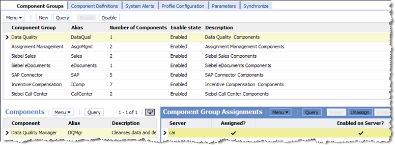

Log into the Siebel web client as a system administrator.
Navigate to Administration - Server Configuration on the Siebel Site Map.
Click Enterprises at the top of the page and select the Component Groups tab.
Find the Data Quality component group and ensure it is enabled.
Check that the component group has been assigned and enabled on the Siebel server, cai, in the following example:
Switch to the Parameters tab and set the Data Cleansing Type parameter to EDQ:
Set the DeDuplication Data Type parameter to EDQ:

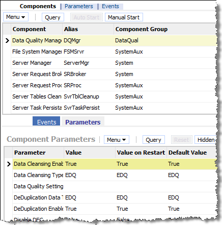

Click Servers at the top of the page, find the Data Quality Manager component and select the Parameters tab.
Ensure the following parameter values are set to EDQ:
Data Cleansing Type
Set the following parameter values to True:
Data Cleansing Enable Flag
DeDuplication Enable Flag
Note :
The preceding illustration shows the values after a server restart, which is performed when Siebel configuration is completed.Repeat steps 8 to 10 for the Siebel application components you want to use with EDQ-CDS. For example:

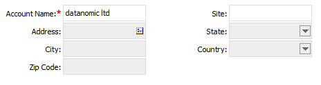

Check that data cleansing is enabled for the server by ensuring that Administration - Data Quality > Data Quality Settings > Enable Data Cleansing is set to "Yes".
Note :
If this setting is changed fromNo to Yes, it is necessary to restart the Siebel Server.Check that data cleansing is enabled for the current user profile by ensuring that Tools > User Preferences > Data Quality > Enable Data Cleansing is set to "Yes".
Note :
If this setting is changed fromNo to Yes, it is necessary to exit the current client session and log in again as the same user.Enter a new Account record with an Account Name in lower case letters.
Save the record.

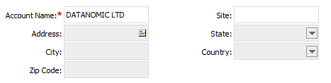

Check that the Account Name has been converted to upper case to verify that the cleaning service has been called.

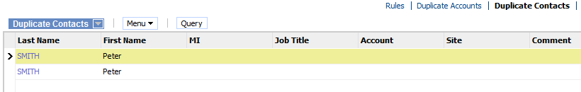

To test the batch matching service for Contact records:
Temporarily disable real-time deduplication for the current user profile by setting Tools > User Preferences > Data Quality > Enable DeDuplication to No.
Note :
If this setting is changed fromNo to Yes it is necessary to restart the Siebel Server.Enter and save two new Contact records with the same name and email address.
Run the Batch contact match job from the Administration - Server page
Verify that the records were matched by checking the Administration - Data Quality > Duplicate Contacts page.

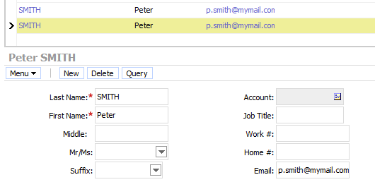

To test the real-time matching service for Contact records:
Check that real-time deduplication is enabled for the current user profile by checking that Tools > User Preferences > Data Quality > Enable DeDuplication is set to Yes.
Set Administration - Data Quality > Data Quality Settings > Force User DeDupe - Contact to Yes.
Enter a new Contact record with the same details as in Section 3.4.3, "Testing the Batch Matching Service."
Save the record.
Verify that the Possible Matching Contacts dialog is displayed showing matches against the two contact records created previously.
An exact name and email match, as in this example, will only match if EDQ is being used for key generation (for Siebel 8.1.1.10 or later), or if the Query and Token expressions used for key generation have been adjusted to use only name, or name and email, attributes.For clarity, the Data Quality Setting parameter found in most of the Templates listed in the table begins with a single double quote mark (") and two single (') quote marks, and ends with one single quote mark and one double.
