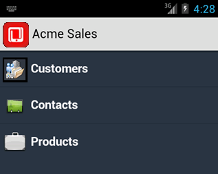

file to set the basic configuration of the mobile application by designating its display name, a unique application ID (to prevent naming collisions) and also by selecting the application features that will display on the application springboard (the equivalent of a home page on a smartphone). Further, this editor enables you to create the user preferences pages for the mobile application. The editor is described in Section 2.2, "Creating a MAF Application,".

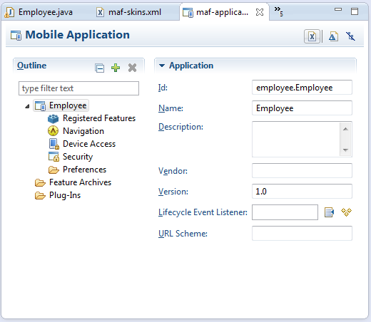

The Application page of the MAF Application Editor, shown in Figure 3-3, enables you to name the mobile application and control the display of the mobile application within the springboard and navigation bar.
Open the MAF Application Editor by double-clicking MAF Application Editor (located in the MAF node of the assembly project in the Project Explorer panel, as shown in Figure 3-3).
To set the basic information for a mobile application:
Choose the Application page by selecting the application's name in the Outline.
By default, the editor opens the Application page.Figure 3-4 shows the portion of the application page where you define the basic information.

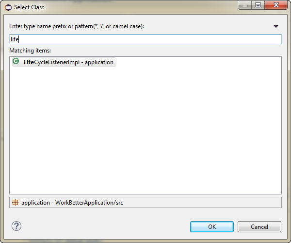

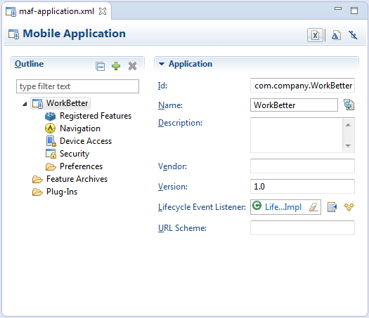

Click Browse next to the Lifecycle Event Listener field to invoke the Edit Property dialog, shown in Figure 3-5, to register the event listener that enables runtime calls for start, stop, activate, and deactivate events. You must enter the fully qualified class name of the event listener. This is an optional field.
If you place the mouse pointer over the label for Lifecycle Event Listener, OEPE displays a tooltip describing the listener class.The default application listener class is application.LifeCycleListenerImpl
. MAF does not register this class by default, because it starts the JVM and therefore may not be preferable for each mobile application. You must instead register this class manually using the Select Class dialog, shown in Figure 3-5. After you close this dialog, OEPE updates the <adfmf:application>
element with a listener-class
attribute, as illustrated in Example 3-1.
The application lifecycle listener must remain within the application controller project (its default location).Example 3-1 Adding the listener-class Attribute
