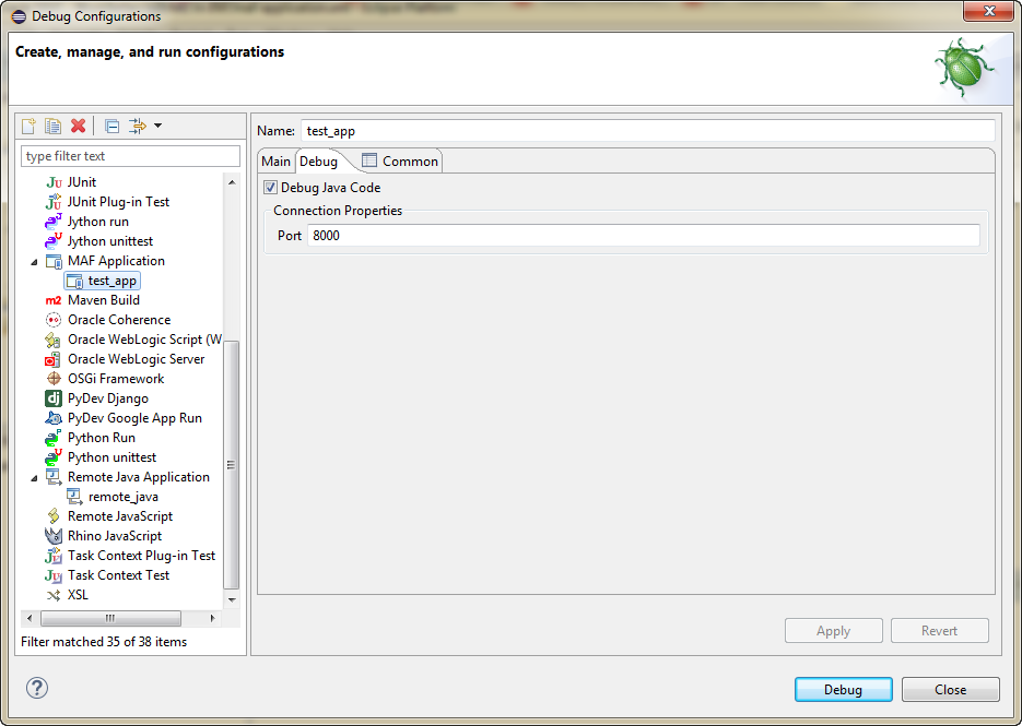

  1. In the debug configuration, click the Debug tab and select Debug Java Code. This sets the following debugging parameter in the cvm.properties file:

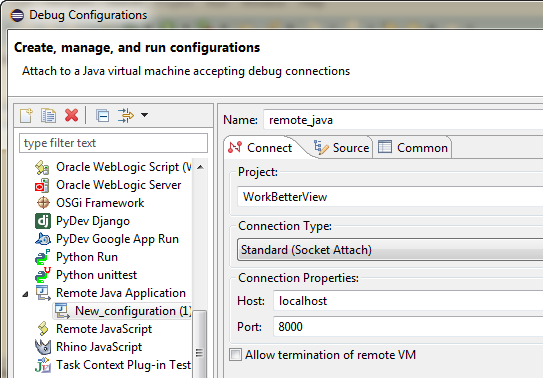

  4. Use a Remote Java Application configuration to connect to the remote VM.
    1. Create a new Remote Java Application configuration. Click Run > Debug Configurations. In the configuration window, double-click Remote Java Application.
    2. Give the configuration a name, and browse to the project of the application you are debugging.

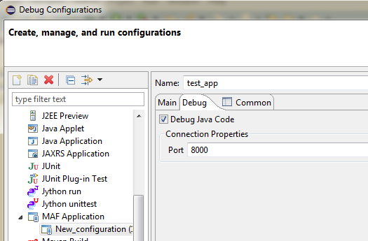

  1. From the OEPE main menu, click Run > Debug Configurations to open the launch configurations dialog.
  2. In the list of configuration types, double-click the MAF Application node.
  3. Give the new MAF Debug configuration a name, and on the Main tab choose the assembly project of the application.
  4. In the Debug tab, select Debug Java Code and set the port to the appropriate port number, as shown in Figure 30-1.
    Figure 30-1 Creating a Debug Configuration
    This image is described in the surrounding text
  5. Click Apply to save the configuration settings.
  6. In the list of configuration types, double-click the Remote Java Applications node. On the Connect tab, as shown in Figure 30-2:
    • Browse to the project you want to debug.
    • Set the host:
      • For simulator or emulator debugging, set to localhost.
      • For remote debugging on Android, set to be the host IP of the computer where the Android Debug Bridge (adb) is running (usually localhost). adb must have port forwarding enabled and the remote debugging port to use is the same port that is forwarded to. Use the command adb forward --list to show all ports to forward to.
      • For remote debugging on iOS, ensure that your development computer can access that device over the network (you may use the ping command to test network access), and then enter the device's IP address.
    • Set the port:
      • For simulator or emulator debugging, set the port to the same port number at the debug configuration.
      • For remote debugging on Android, adb (Android Debug Bridge) must have port forwarding enabled. Set the port to the same port that is forwarded to. Use the command adb forward --list to show all ports to forward to.
      • For remote debugging on iOS, set the port to the same port number at the debug configuration.
    Figure 30-2 Configuring Remote Debugging
MAF specifies the following debugging parameter in the cvm.properties file:
java.debug.port=8000
This port number matches the one set in OEPE.

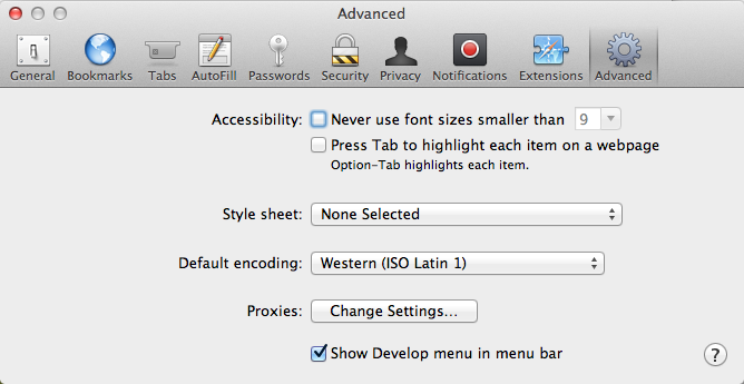

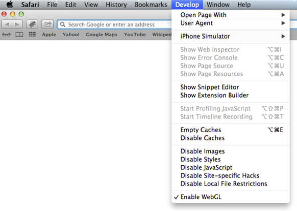

30.3.5.1 What You May Need to Know About Debugging of JavaScript Using an iOS-Powered Device Simulator on iOS 6 Platform
If you are working with the iOS 6 platform, you can use the Safari 6 browser to debug JavaScript. To do so, open the Safari preferences, select Advanced, and then enable the Develop menu in the browser by selecting Show Develop menu in menu bar, as shown in Figure 30-4.
Figure 30-4 Enabling Safari Browser Options
When the Develop menu is enabled, select either iPhone Simulator or iPad Simulator, as Figure 30-5 and Figure 30-6 show, and then select a UIWebView that you are planning to debug. Whether the Develop menu displays an iPhone Simulator or iPad Simulator option depends on which device simulator is launched.
Figure 30-5 Using Develop Menu on Safari Browser for Debugging on iPhone Simulator

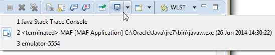

There are two consoles in OEPE available when running applications on devices: iOS Console and for each device (including emulator) additional console for Android. Both types of console can stream the logging and standard output, using two additional logging.properties file properties which allow you to filter the output to the OEPE console:
oepe.console.filter.android=<some string>
oepe.sonsole.filter.ios=<some string>
You switch from one console to another using the Display Selected Console button in the Console menubar. To cycle through the consoles available, click This image is described in the surrounding text. Alternatively, click the down arrow next to the button and choose from the list, as shown in Section 30.4.1, "Choosing the Console.".
