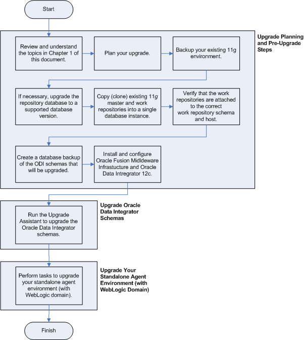

Figure 4-1 provides a roadmap of the tasks required to upgrade your standalone agent that is managed by OPMN and registered to a WebLogic domain.
Figure 4-1 Upgrade Process for a Standalone Agent Managed by OPMN and Registered to a WebLogic Domain
Table 4-1 describes each of the steps in the upgrade process flowchart which is shown in Figure 4-1. The table also provides information on where to go to get more information on each step in the process.
Table 4-1 Oracle Data Integrator Upgrade Process
| Task | Description | More Information |
| Review and understand the topics in Chapter 1 of this document. | This chapter provides important information you should read and understand before beginning your upgrade process. | |
| Plan your upgrade. | Understand important concepts and tasks when planning your upgrade. | |
| Backup your existing 11g environment. | Before you begin your upgrade, make a complete backup of your existing 11g environment. | |
| If necessary, upgrade the repository database to a supported database version | The Oracle Data Integrator Repositories are stored into database schemas. Before you can upgrade these schemas, you must make sure the database is a supported version. | |
| Copy (clone) existing Master and Work Repositories before running the Upgrade Assistant | Oracle recommends that you perform repository upgrades on cloned repository schemas. | |
| Verify that the work repositories are attached to the correct master repository schema and host | The Upgrade Assistant upgrades all work repositories attached to master repository. Each work repository must be attached to the correct master repository schema and host before performing the upgrade. | |
| Create a database backup of the ODI schema that will be upgraded. | Creating a backup is mandatory if the repository schemas have not been cloned and you are attempting to upgrade a non-cloned schema. Performing a backup of the ODI schemas is particularly important if the upgrade fails and corrupts the content. With a backup, you can delete the corrupted schemas and re-clone the originals to complete the upgrade. | |
| Install and Configure the necessary Oracle Fusion Middleware 12c products | Install Oracle Fusion Middleware Infrastructure and Oracle Data Integrator 12c. The Upgrade Assistant is available as part of the 12c product installation. | |
| Run Upgrade Assistant to Upgrade the Oracle Data Integrator Master Repository and Work Repository schema. | The Upgrade Assistant upgrades the Oracle Data Integrator 11g repository schemas to Oracle Data Integrator 12c. | |
| Upgrade your standalone agent environment (with WebLogic domain). | After upgrading the 11g schemas, you can upgrade your standalone agent environment (with WebLogic domain). Tasks to do so include:
