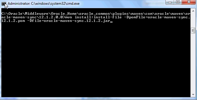

To run the plug-in you first need to install it on your Maven repository. You can install it into your local repository on your computer, or you can deploy it into a remote shared internal repository.
To install the plug-in to a local repository using the command line:
In a command prompt, navigate to the location of your Maven plug-in jar located at ORACLE_COMMON/oracle_common/plugins/maven/com/oracle/maven/oracle-maven-sync/12.1.3
Run the following command to install to the default repository:
mvn install:install-file -DpomFile=oracle-maven-sync.12.1.3.pom -Dfile=oracle-maven-sync.12.1.3.jar
Run the following command to install to a specified directory:
mvn install:install-file -DpomFile=oracle-maven-sync.12.1.3.pom -Dfile=oracle-maven-sync.12.1.3.jar -Dmaven.repo.local=<path to local repository>

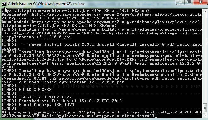

To populate your repository with the Maven archetypes, run the clean install, and archetype update local catalog commands, as shown in Figure 6-2 and Figure 6-3.
Install the Maven archetypes from the command line.
To install the Maven archetypes:
Open a command prompt and navigate to the archetype directory of your plugins install: {OEPE install}/plugins/oracle.eclipse.tools.adf/maven/ADF Basic Application Archetype
Run the following command:
mvn clean install

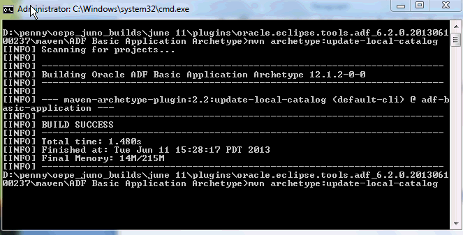

Run a second command:
mvn archetype:update-local-catalog

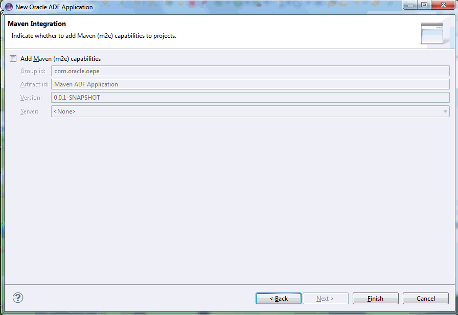

From OEPE using the New ADF Application Wizard

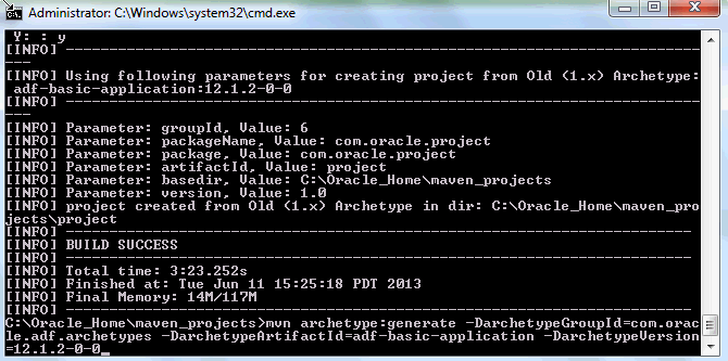

You can create an ADF application using the command line.
To create an ADF application from the command line:
Open a command prompt and navigate to your project location.
mvn archetype:generate -DarchetypeGroupId=com.oracle.adf.archetype -DarchetypeArtifactId=adf-basic-application -DarchetypeVersion=12.1.3-0-0
Enter the appropriate required values for groupId
, artifactId
, version
, and package
, as shown in Figure 6-4.
Change directory to newly-created top-level Maven project folder.
Execute the following command:
mvn clean install

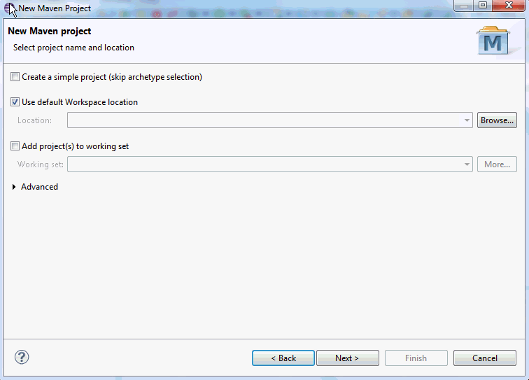

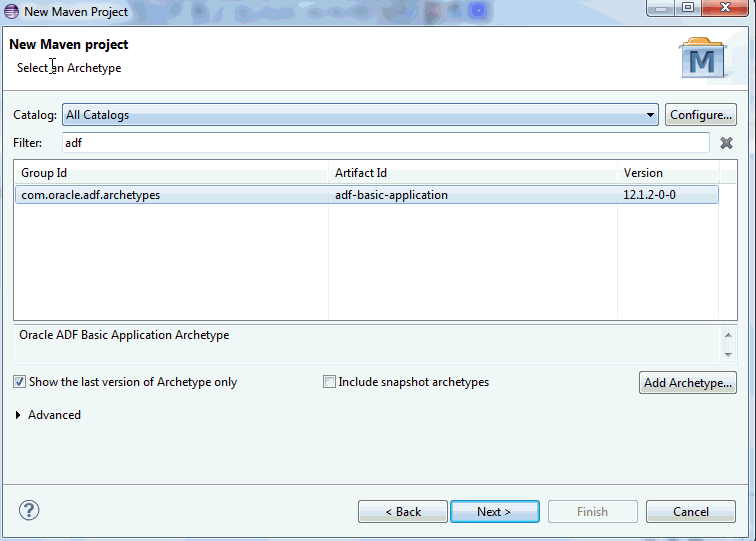

You can create a Maven application using the Maven Project wizard.
To create a Maven application from the application wizard:
In your OEPE Eclipse application go to File > New > Project. In the New Project dialog expand the Maven directory and select Maven Project and click Next.
In the New Maven Project dialog, select your project name and location, as shown in Figure 6-5.
Click Next. The Select an Archetype dialog appears. Select the ADF archetype called com.oracle.adf.archetypes

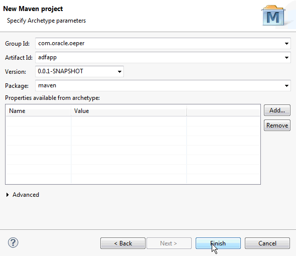

, as shown in Figure 6-6. Type "adf" as a filter to filter out the many other options.
Select the ADF archetype and click Next.
Enter your values in the dialog fields, as shown in Figure 6-7.
Click Finish. The new Maven application appears in your Project Explorer window.
OEPE provides the option to add Maven capabilities to projects in your new ADF application.
To add Maven integration to new ADF application projects:
Go to File > New > ADF Application. You are creating an ADF application in which you will add Maven capabilities to the application projects.
Add the information required for you new ADF application on the first two wizard pages.
The third wizard page is the Maven Integration Page, as shown in Figure 6-8.
Check the Add Maven (m2e) capabilities to projects box. This adds Maven capabilities.
Click Finish.

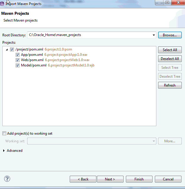

In OEPE you can import your existing Maven projects into your working application. ADF applications can be imported as well as any J2EE Maven application built outside the OEPE framework.
To import an existing Maven project:

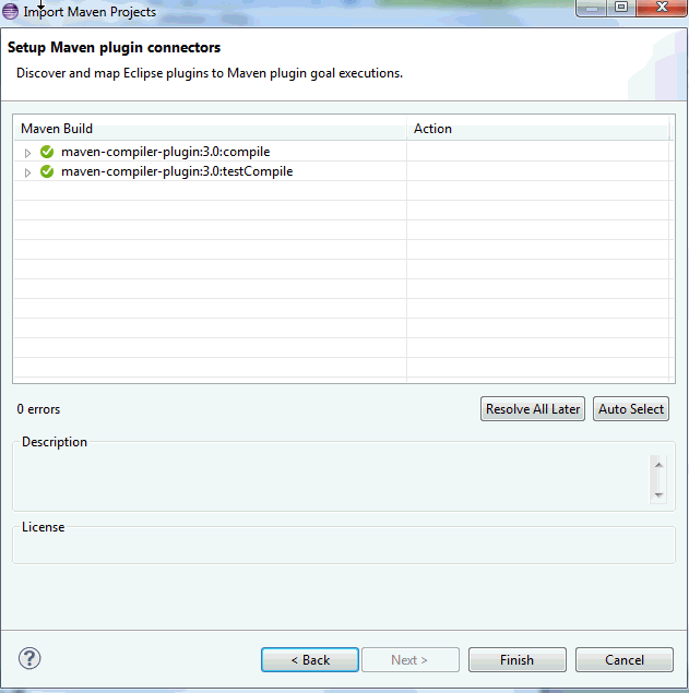

In your OEPE application choose File > Import > Maven > Existing maven projects.
Click Next. the Select Maven Projects dialog appears. Enter the root directory for the Maven project you are importing, and select your project, as shown in Figure 6-9.
Click Next. The connectors dialog appears. Setup your Maven plugin connectors, as shown in Figure 6-10.
Click Finish.

Use the command line to deploy using Maven to a running WebLogic server instance.
To Use the Command Line to Deploy using Maven to a Running WebLogic Server:
Open a command prompt and navigate to …/{artifactId}/App
, where {artifactId
} is the name specified during archetype creation.
mvn com.oracle.weblogic:weblogic-maven-plugin:redeploy -Dwls.adminurl=t3://localhost:7001 -Dwls.user=weblogic -Dwls.password=welcome1
