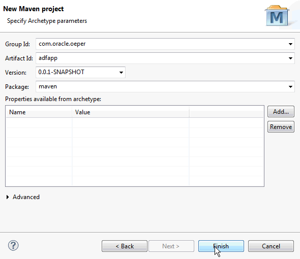

  5. Enter your values in the dialog fields, as shown in Figure 6-7.
  6. Click Finish. The new Maven application appears in your Project Explorer window.

    Figure 6-7 Creating a New Maven Project - Specifying the Archetype Parameters
    new maven project detail
