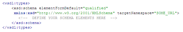

This example shows how inline types define the JAXB type information in an embedded schema element in the types section of the WSDL file.

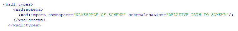

This example demonstrates the case of imported schemas, where the customizations editor supports importing schemas directly from the WSDL file using the schema import mechanism. The import element must define a namespace and a schemaLocation attribute. Note that imports in the imported schemas will not be followed.
