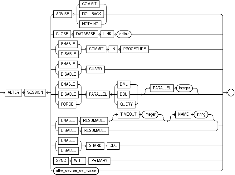

Syntax
alter_session::=
Description of the illustration alter_session.eps
alter_session_set_clause::=
Description of the illustration alter_session_set_clause.eps
