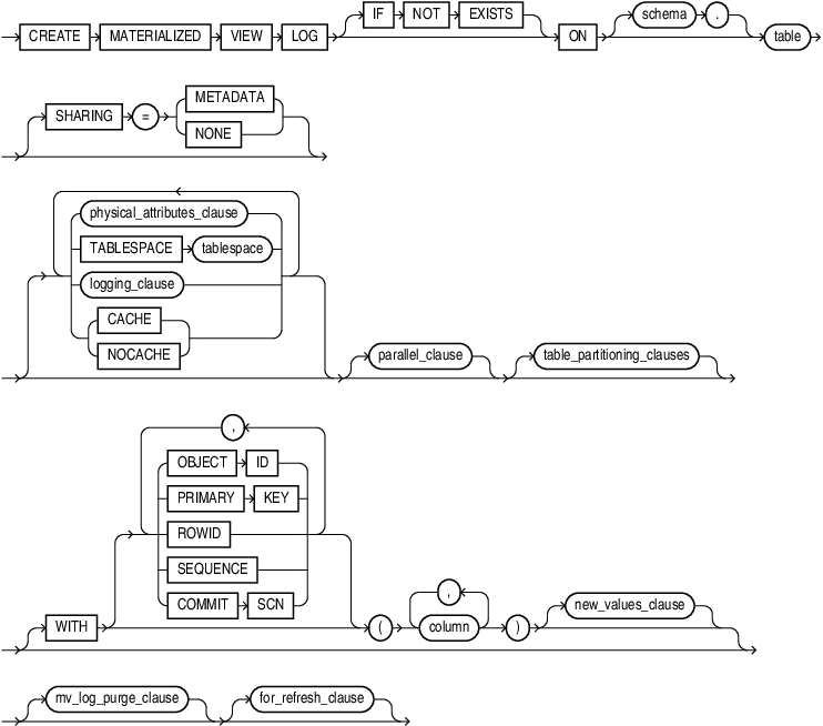

create_materialized_vw_log::=
(physical_attributes_clause::=, logging_clause::=, parallel_clause::=, table_partitioning_clauses::= (in CREATE TABLE), new_values_clause::=, mv_log_purge_clause::=, for_refresh_clause::=.)

Semantics
IF NOT EXISTS

schema
Specify the schema containing the materialized view log master table. If you omit schema, then Oracle Database assumes the master table is contained in your own schema. Oracle Database creates the materialized view log in the schema of its master table. You cannot create a materialized view log for a table in the schema of the user SYS.
table
Specify the name of the master table for which the materialized view log is to be created. Oracle Database encrypts any columns in the materialized view log that are encrypted in the master table, using the same encryption algorithm.

SHARING
Use the sharing clause if you want to create the object in an application root in the context of an application maintenance. This type of object is called an application common object and it can be shared with the application PDBs that belong to the application root.
You can specify how the object is shared using one of the following sharing attributes:
Use the physical_attributes_clause to define physical and storage characteristics for the materialized view log.
See Also: physical_attributes_clause and storage_clause for a complete description these clauses, including default values
TABLESPACE Clause
Specify the tablespace in which the materialized view log is to be created. If you omit this clause, then the database creates the materialized view log in the default tablespace of the schema of the materialized view log.
logging_clause
Specify either LOGGING or NOLOGGING to establish the logging characteristics for the materialized view log. The default is the logging characteristic of the tablespace in which the materialized view log resides.

CACHE | NOCACHE
For data that will be accessed frequently, CACHE specifies that the blocks retrieved for this log are placed at the most recently used end of the least recently used (LRU) list in the buffer cache when a full table scan is performed. This attribute is useful for small lookup tables.
NOCACHE specifies that the blocks are placed at the least recently used end of the LRU list. The default is NOCACHE.

parallel_clause
The parallel_clause lets you indicate whether parallel operations will be supported for the materialized view log.
Use the table_partitioning_clauses to indicate that the materialized view log is partitioned on specified ranges of values or on a hash function. Partitioning of materialized view logs is the same as partitioning of tables.

WITH Clause
Use the WITH clause to indicate whether the materialized view log should record the primary key, rowid, object ID, or a combination of these row identifiers when rows in the master are changed. You can also use this clause to add a sequence to the materialized view log to provide additional ordering information for its records.
This clause also specifies whether the materialized view log records additional columns that might be referenced as filter columns, which are non-primary-key columns referenced by subquery materialized views, or join columns, which are non-primary-key columns that define a join in the subquery WHERE clause.
If you omit this clause, or if you specify the clause without PRIMARY KEY, ROWID, or OBJECT ID, then the database stores primary key values by default. However, the database does not store primary key values implicitly if you specify only OBJECT ID or ROWID at create time. A primary key log, created either explicitly or by default, performs additional checking on the primary key constraint.

PRIMARY KEY
Specify PRIMARY KEY to indicate that the primary key of all rows changed should be recorded in the materialized view log.
ROWID
Specify ROWID to indicate that the rowid of all rows changed should be recorded in the materialized view log.
SEQUENCE
Specify SEQUENCE to indicate that a sequence value providing additional ordering information should be recorded in the materialized view log. Sequence numbers are necessary to support fast refresh after some update scenarios.

COMMIT SCN
Without the COMMIT SCN clause, the materialized view log is based on timestamps and requires some setup operations when preparing to refresh the materialized view. Specify COMMIT SCN to instruct the database to use commit SCN data rather than timestamps. This setting removes the need for the setup operations and thus can improve the speed of the materialized view refresh.

column
Specify the columns whose values you want to be recorded in the materialized view log for all rows that are changed. Typically these columns are filter columns and join columns.

NEW VALUES Clause
The NEW VALUES clause lets you determine whether Oracle Database saves both old and new values for update DML operations in the materialized view log.

mv_log_purge_clause
Use this clause to specify the purge time for the materialized view log.
IMMEDIATESYNCHRONOUS: the materialized view log is purged immediately after refresh. This is the default. -
IMMEDIATEASYNCHRONOUS: the materialized view log is purged in a separate Oracle Scheduler job after the refresh operation. -
STARTWITH,NEXT, andREPEATINTERVALset up a scheduled purge that is independent of the materialized view refresh and is initiated duringCREATEorALTERMATERIALIZEDVIEWLOGstatement. This is very similar to scheduled refresh syntax in aCREATEorALTERMATERIALIZEDVIEWstatement:-

for_refresh_clause
Use this clause to specify the refresh method for which the materialized view log will be used. You can specify only one refresh method for any given master table.
FOR SYNCHRONOUS REFRESH
Specify this clause to create a staging log that can be used for synchronous refresh. Use staging_log_name to specify the name of the staging log to be created. The staging log will be created in the schema in which the master table resides.

FOR FAST REFRESH
Specify this clause to create a materialized view log that can be used for fast refresh. The materialized view log will be created in the same schema in which the master table resides. This is the default.

CREATE MATERIALIZED VIEW LOG ON customers
PCTFREE 5
TABLESPACE example
STORAGE (INITIAL 10K);
The materialized view log on customers supports fast refresh for primary key materialized views only.
The following statement creates another version of the materialized view log with the ROWID clause, which enables fast refresh for more types of materialized views:
CREATE MATERIALIZED VIEW LOG ON customers WITH PRIMARY KEY, ROWID;
This materialized view log on customers makes fast refresh possible for rowid materialized views and for materialized join views. To provide for fast refresh of materialized aggregate views, you must also specify the SEQUENCE and INCLUDING NEW VALUES clauses, as shown in the example that follows.
Specify a Purge Repeat Interval for a Materialized View Log: Example
The following statement creates a materialized view log on the oe.orders table. The contents of the log will be purged once every five days, beginning five days after the creation date of the materialized view log:
CREATE MATERIALIZED VIEW LOG ON orders
PCTFREE 5
TABLESPACE example
PURGE REPEAT INTERVAL '5' DAY;
Specifying Filter Columns for Materialized View Logs: Example
The following statement creates a materialized view log on the sh.sales table and is used in “Creating Materialized Aggregate Views: Example”. It specifies as filter columns all of the columns of the table referenced in that materialized view.
CREATE MATERIALIZED VIEW LOG ON sales
WITH ROWID, SEQUENCE(amount_sold, time_id, prod_id)
INCLUDING NEW VALUES;
Specifying Join Columns for Materialized View Logs: Example
The following statement creates a materialized view log on the order_items table of the sample oe schema. The log records primary keys and product_id, which is used as a join column in “Creating a Fast Refreshable Materialized View: Example”.
CREATE MATERIALIZED VIEW LOG ON order_items WITH (product_id);
Including New Values in Materialized View Logs: Example
The following example creates a materialized view log on the oe.product_information table that specifies INCLUDING NEW VALUES:
CREATE MATERIALIZED VIEW LOG ON product_information
WITH ROWID, SEQUENCE (list_price, min_price, category_id), PRIMARY KEY
You could create the following materialized aggregate view to use the product_information log:
CREATE MATERIALIZED VIEW products_mv
REFRESH FAST ON COMMIT
AS SELECT SUM(list_price - min_price), category_id
FROM product_information
GROUP BY category_id;
This materialized view is eligible for fast refresh because the log defined on its master table includes both old and new values.
Creating a Staging Log for Synchronous Refresh: Example
The following statement creates a staging log on the sh.sales fact table. The staging log is named mystage_log and is stored in the sh schema. It can be used for synchronous refresh.
PCTFREE 5
TABLESPACE example
FOR SYNCHRONOUS REFRESH USING mystage_log;
