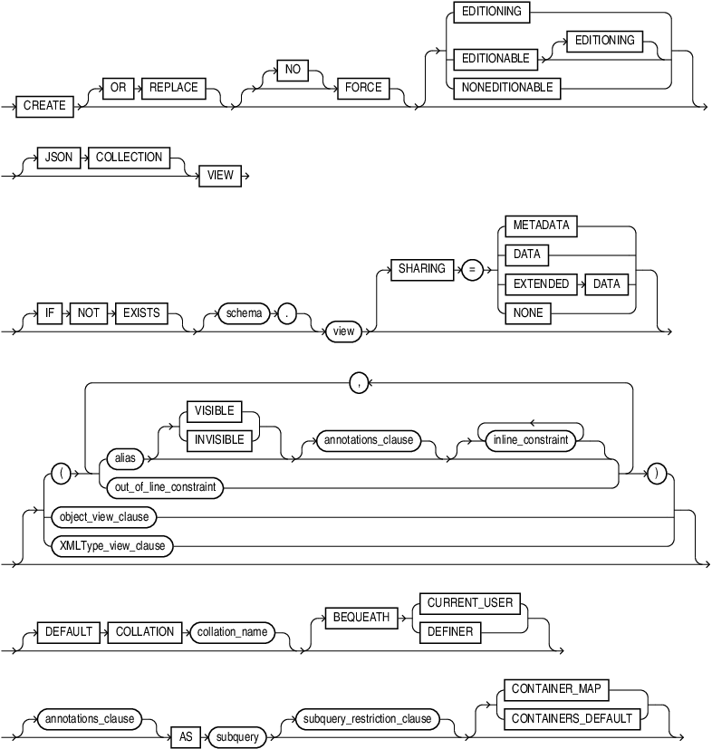

Syntax
create_view::=
(inline_constraint::= and out_of_line_constraint::=, object_view_clause::=, XMLType_view_clause::=, subquery::=-part of SELECT, subquery_restriction_clause::=, annotations_clause)
