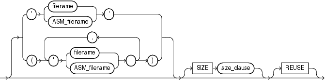

file_specification::=
Description of file_specification.gif follows

redo_log_file_spec::=
Description of redo_log_file_spec.gif follows
