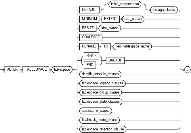

Syntax
alter_tablespace::=
Description of alter_tablespace.gif follows
(table_compression ::=--part of ALTER TABLE, storage_clause::=, size_clause::=, datafile_tempfile_clauses ::=, tablespace_logging_clauses ::=, tablespace_group_clause::=, tablespace_state_clauses::=, autoextend_clause ::=, flashback_mode_clause ::=, tablespace_retention_clause::=)

Semantics
tablespace
Specify the name of the tablespace to be altered.
Restrictions on Altering Tablespaces Altering tablespaces is subject to the following restrictions:

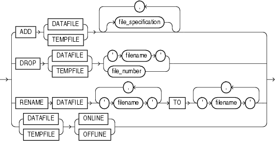

The tablespace file clauses let you add or modify a datafile or tempfile.
ADD Clause
Specify ADD to add to the tablespace a datafile or tempfile specified by file_specification. Use the datafile_tempfile_spec form of file_specification (see file_specification) to list regular datafiles and tempfiles in an operating system file system or to list Automatic Storage Management disk group files.
For locally managed temporary tablespaces, this is the only clause you can specify at any time.
If you omit file_specification, then Oracle Database creates an Oracle-managed file of 100M with AUTOEXTEND enabled.
You can add a datafile or tempfile to a locally managed tablespace that is online or to a dictionary managed tablespace that is online or offline. Ensure the file is not in use by another database.
Restriction on Adding Datafiles and Tempfiles You cannot specify this clause for a bigfile (single-file) tablespace, as such a tablespace has only one datafile or tempfile.
On some operating systems, Oracle does not allocate space for a tempfile until the tempfile blocks are actually accessed. This delay in space allocation results in faster creation and resizing of tempfiles, but it requires that sufficient disk space is available when the tempfiles are later used. To avoid potential problems, before you create or resize a tempfile, ensure that the available disk space exceeds the size of the new tempfile or the increased size of a resized tempfile. The excess space should allow for anticipated increases in disk space use by unrelated operations as well. Then proceed with the creation or resizing operation.
DROP Clause
Specify DROP to drop from the tablespace an empty datafile or tempfile specified by filename or file_number. This clause causes the datafile or tempfile to be removed from the data dictionary and deleted from the operating system. The database must be open at the time this clause is specified.
The ALTER TABLESPACE ... DROP TEMPFILE statement is equivalent to specifying the ALTER DATABASE TEMPFILE ... DROP INCLUDING DATAFILES.
Restrictions on Dropping Files To drop a datafile or tempfile, the datafile or tempfile:
  • Must be empty.
  • Cannot be the first file that was created in the tablespace. In such cases, drop the tablespace instead.
  • Cannot be in a read-only tablespace.
See Also:
RENAME DATAFILE Clause
Specify RENAME DATAFILE to rename one or more of the tablespace datafiles. The database must be open, and you must take the tablespace offline before renaming it. Each filename must fully specify a datafile using the conventions for filenames on your operating system.
This clause merely associates the tablespace with the new file rather than the old one. This clause does not actually change the name of the operating system file. You must change the name of the file through your operating system.

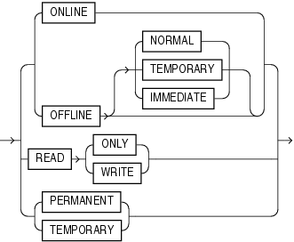

Use these clauses to set or change the state of the tablespace.
ONLINE | OFFLINE
Specify ONLINE to bring the tablespace online. Specify OFFLINE to take the tablespace offline and prevent further access to its segments. When you take a tablespace offline, all of its datafiles are also offline.
Suggestion:
Before taking a tablespace offline for a long time, consider changing the tablespace allocation of any users who have been assigned the tablespace as either a default or temporary tablespace. While the tablespace is offline, such users cannot allocate space for objects or sort areas in the tablespace. See ALTER USER for more information on allocating tablespace quota to users.
Restriction on Taking Tablespaces Offline You cannot take a temporary tablespace offline.
OFFLINE NORMAL Specify NORMAL to flush all blocks in all datafiles in the tablespace out of the system global area (SGA). You need not perform media recovery on this tablespace before bringing it back online. This is the default.
OFFLINE TEMPORARY If you specify TEMPORARY, then Oracle Database performs a checkpoint for all online datafiles in the tablespace but does not ensure that all files can be written. Files that are offline when you issue this statement may require media recovery before you bring the tablespace back online.
OFFLINE IMMEDIATE If you specify IMMEDIATE, then Oracle Database does not ensure that tablespace files are available and does not perform a checkpoint. You must perform media recovery on the tablespace before bringing it back online.
The FOR RECOVER setting for ALTER TABLESPACE ... OFFLINE has been deprecated. The syntax is supported for backward compatibility. However, Oracle recommends that you use the transportable tablespaces feature for tablespace recovery.
See Also:
Oracle Database Backup and Recovery Advanced User's Guide for information on using transportable tablespaces to perform media recovery
READ ONLY | READ WRITE
Specify READ ONLY to place the tablespace in transition read-only mode. In this state, existing transactions can complete (commit or roll back), but no further DML operations are allowed to the tablespace except for rollback of existing transactions that previously modified blocks in the tablespace. You cannot make the SYSAUX tablespace READ ONLY.
When a tablespace is read only, you can copy its files to read-only media. You must then rename the datafiles in the control file to point to the new location by using the SQL statement ALTER DATABASE ... RENAME.
See Also:
Specify READ WRITE to indicate that write operations are allowed on a previously read-only tablespace.
PERMANENT | TEMPORARY
Specify PERMANENT to indicate that the tablespace is to be converted from a temporary to a permanent tablespace. A permanent tablespace is one in which permanent database objects can be stored. This is the default when a tablespace is created.
Specify TEMPORARY to indicate that the tablespace is to be converted from a permanent to a temporary tablespace. A temporary tablespace is one in which no permanent database objects can be stored. Objects in a temporary tablespace persist only for the duration of the session.
Restrictions on Temporary Tablespaces Temporary tablespaces are subject to the following restrictions:
  • You cannot specify TEMPORARY for the SYSAUX tablespace.
  • If tablespace was not created with a standard block size, then you cannot change it from permanent to temporary.
  • You cannot specify TEMPORARY for a tablespace in FORCE LOGGING mode.

Adding and Dropping Datafiles and Tempfiles: Examples The following statement adds a datafile to the tablespace. When more space is needed, new 10-kilobytes extents will be added up to a maximum of 100 kilobytes:
ALTER TABLESPACE tbs_03
    ADD DATAFILE 'tbs_f04.dbf'
    SIZE 100K
    AUTOEXTEND ON
    NEXT 10K
    MAXSIZE 100K;
The following statement drops the empty datafile:
    DROP DATAFILE 'tbs_f04.dbf';
The following statements add a tempfile to the temporary tablespace created in "Creating a Temporary Tablespace: Example" and then drops the tempfile:
ALTER TABLESPACE temp_demo ADD TEMPFILE 'temp05.dbf' SIZE 5 AUTOEXTEND ON;
ALTER TABLESPACE temp_demo DROP TEMPFILE 'temp05.dbf';
Adding an Oracle-managed Datafile: Example The following example adds an Oracle-managed datafile to the omf_ts1 tablespace (see "Creating Oracle-managed Files: Examples" for the creation of this tablespace). The new datafile is 100M and is autoextensible with unlimited maximum size:
ALTER TABLESPACE omf_ts1 ADD DATAFILE;
