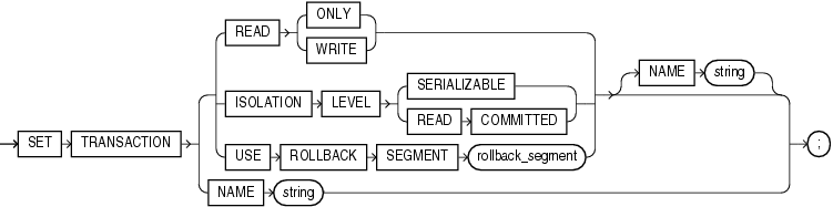

Syntax
set_transaction::=
Description of set_transaction.gif follows
