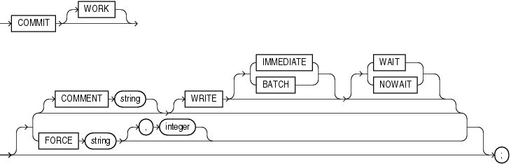

All clauses after the COMMIT
keyword are optional. If you specify only COMMIT
, then the default is COMMIT
WORK
WRITE
IMMEDIATE
WAIT

Specify a comment to be associated with the current transaction. The 'text
' is a quoted literal of up to 255 bytes that Oracle Database stores in the data dictionary view DBA_2PC_PENDING
along with the transaction ID if a distributed transaction becomes in doubt. This comment can help you diagnose the failure of a distributed transaction.

if you omit this clause, then the behavior of the commit operation is controlled by theCOMMIT_WRITE
initialization parameter, if it as been set. The default value of the parameter is the same as the default for this clause. Therefore, if the parameter has not been set and you omit this clause, then commit records are written to disk before control is returned to the user.IMMEDIATE The IMMEDIATE
parameter initiates I/O, causing the redo for the commit of the transaction to be written out immediately by sending a message to the LGWR process. If you specify neither IMMEDIATE
nor BATCH
, then IMMEDIATE
is the default.
BATCH The BATCH
parameter causes the redo to be buffered to the redo log. No I/O is initiated.
WAIT The WAIT
parameter ensures that the commit will not return until the corresponding redo is persistent in the online redo log. If you specify neither WAIT
nor NOWAIT
, then WAIT
is the default.
NOWAIT The NOWAIT
parameter allows the commit to return before the redo is persistent in the redo log.

Oracle Database Application Developer's Guide - Fundamentals for more information on asynchronous commitIn a distributed database system, the FORCE
clause lets you manually commit an in-doubt distributed transaction. The transaction is identified by the 'string
' containing its local or global transaction ID. To find the IDs of such transactions, query the data dictionary view DBA_2PC_PENDING
. You can use integer
to specifically assign the transaction a system change number (SCN). If you omit integer
, then the transaction is committed using the current SCN.
