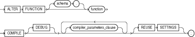

alter_function::=
Description of alter_function.gif follows

Semantics
schema
Specify the schema containing the function. If you omit schema, Oracle Database assumes the function is in your own schema.
function
Specify the name of the function to be recompiled.
COMPILE
Specify COMPILE to cause Oracle Database to recompile the function. The COMPILE keyword is required. If Oracle Database does not compile the function successfully, you can see the associated compiler error messages with the SQL*Plus command SHOW ERRORS.
