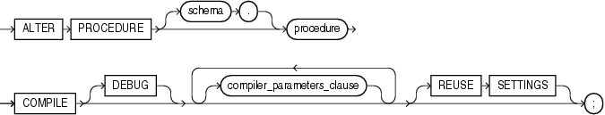

alter_procedure::=
Description of alter_procedure.gif follows
