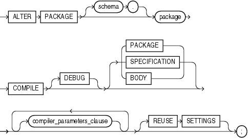

alter_package::=
Description of alter_package.gif follows

Semantics
schema
Specify the schema containing the package. If you omit schema, then Oracle Database assumes the package is in your own schema.
package
Specify the name of the package to be recompiled.
COMPILE
You must specify COMPILE to recompile the package specification or body. The COMPILE keyword is required.
During recompilation, Oracle Database drops all persistent compiler switch settings, retrieves them again from the session, and stores them at the end of compilation. To avoid this process, specify the REUSE SETTINGS clause.
If recompiling the package results in compilation errors, then Oracle Database returns an error and the body remains invalid. You can see the associated compiler error messages with the SQL*Plus command SHOW ERRORS.
SPECIFICATION
Specify SPECIFICATION to recompile only the package specification, regardless of whether it is invalid. You might want to recompile a package specification to check for compilation errors after modifying the specification.
When you recompile a package specification, Oracle Database invalidates any local objects that depend on the specification, such as procedures that call procedures or functions in the package. The body of a package also depends on its specification. If you subsequently reference one of these dependent objects without first explicitly recompiling it, Oracle Database recompiles it implicitly at run time.
BODY
Specify BODY to recompile only the package body regardless of whether it is invalid. You might want to recompile a package body after modifying it. Recompiling a package body does not invalidate objects that depend upon the package specification.
When you recompile a package body, Oracle Database first recompiles the objects on which the body depends, if any of those objects are invalid. If Oracle Database recompiles the body successfully, the body becomes valid.
PACKAGE
Specify PACKAGE to recompile both the package specification and the package body if one exists, regardless of whether they are invalid. This is the default. The recompilation of the package specification and body lead to the invalidation and recompilation of dependent objects as described for SPECIFICATION and BODY.
See Also:
Oracle Database Concepts for information on how Oracle Database maintains dependencies among schema objects, including remote objects
DEBUG
Specify DEBUG to instruct the PL/SQL compiler to generate and store the code for use by the PL/SQL debugger. Specifying this clause has the same effect as specifying PLSQL_DEBUG = TRUE in the compiler_parameters_clause.
See Also:
PL/SQL Packages and Types Reference for information on debugging packages
This clause has the same behavior for a package as it does for a function. Please refer to the ALTER FUNCTION compiler_parameters_clause.
REUSE SETTINGS
This clause has the same behavior for a package as it does for a function. Please refer to the ALTER FUNCTION clause REUSE SETTINGS.
