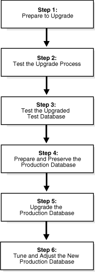

The major steps in the upgrade process are illustrated in Figure 1-1.
The upgrade steps apply to all operating systems, with the possible exception of a few operating system-specific details identified in your operating system-specific Oracle documentation.
The following list outlines the major steps performed during the upgrade process. Detailed instructions are provided in the appropriate chapters later in this book.
Step 1: Prepare to Upgrade
  • Become familiar with the features of the new Oracle Database 10g release.
  • Determine the upgrade path to the new Oracle Database 10g release.
  • Choose an upgrade method.
  • Choose an Oracle home directory for the new Oracle Database 10g release.
  • Develop a testing plan.
  • Prepare a backup strategy.
Step 2: Test the Upgrade Process
  • Perform a test upgrade using a test database. The test upgrade should be conducted in an environment created for testing and should not interfere with the actual production database.
Step 3: Test the Upgraded Test Database
  • Perform the tests you planned in Step 1 on the test database and on the test database that was upgraded to the new Oracle Database 10g release.
  • Compare results, noting anomalies between test results on the test database and on the upgraded database.
  • Investigate ways to correct any anomalies you find and then implement the corrections.
  • Repeat Step 1, Step 2, and the first parts of Step 3, as necessary, until the test upgrade is completely successful and works with any required applications.
Chapter 2, "Preparing to Upgrade" provides detailed information about Steps 1 through 3.
Step 4: Prepare and Preserve the Production Database
  • Prepare the current production database as appropriate to ensure the upgrade to the new Oracle Database 10g release will be successful.
  • Schedule the downtime required for backing up and upgrading the production database.
  • Back up the current production database. Perform a full or an incremental backup, as necessary, to ensure your database is protected against data loss.
Step 5: Upgrade the Production Database
  • Upgrade the production database to the new Oracle Database 10g release.
  • After the upgrade, perform a full backup of the production database and perform other post-upgrade tasks.
Chapter 3 describes Steps 4 and 5 when using the Database Upgrade Assistant or when performing a manual upgrade. Chapter 4 describes the backup procedure after the upgrade and other post-upgrade tasks.
Step 6: Tune and Adjust the New Production Database
  • Tune the new Oracle Database production database. The new Oracle Database production database should perform as good as, or better than, the database prior to the upgrade. Chapter 4 describes these adjustments.
  • Determine which features of the new Oracle Database 10g release you want to use and update your applications accordingly.
  • Develop new database administration procedures, as needed.
  • Do not upgrade production users to the new Oracle Database until all applications have been tested and operate properly. Chapter 6 describes considerations for updating applications.

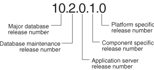

Oracle Release Numbers
This book describes moving between different releases of the Oracle database server. Figure 1-2 describes what each part of a release number represents.
Figure 1-2 Example of an Oracle Release Number
Description of Figure 1-2 follows
Description of "Figure 1-2 Example of an Oracle Release Number"
Starting with Oracle9i release 9.2, maintenance releases of Oracle are denoted by a change to the second digit of a release number. In previous releases, the third digit indicated a particular maintenance release.
See Also:
Oracle Database Administrator's Guide for more information about Oracle release numbers
When a statement is made in this book about a major database release number, the statement applies to all releases within that major database release. References to Oracle Database include release 10.1 and 10.2; references to Oracle9i include release 9.0.1 and release 9.2.
Similarly, when a statement is made in this book about a maintenance release, the statement applies to all component-specific (also referred to as patch set releases) and platform-specific releases within that maintenance release. So, a statement about release 9.2 applies to release 9.2.0.1, release 9.2.0.2, and all other platform-specific releases within release 9.2.
