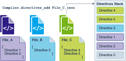

You can add directive files through diagnostic commands to the TestProgram while it is running:
  • To add all directives from File_C to the directives stack, enter the following command.
    jcmd 11084 Compiler.directives_add File_C.json
  • Figure 2-4 shows that the order of directives in the stack becomes is [4, 5, 3, 1, 2, 0].
Figure 2-4 Adding multiple Directives to a Running Program
Description of Figure 2-4 follows
Description of "Figure 2-4 Adding multiple Directives to a Running Program"
