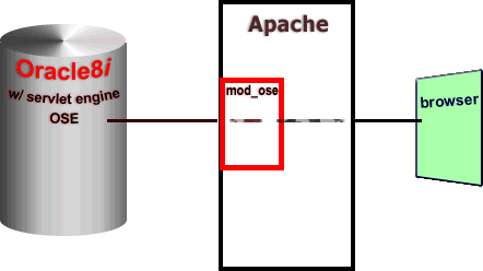

Figure 5-1 Simple Topology of the Apache Web Server and Oracle's Servlet Engine (OSE), Using mod_ose

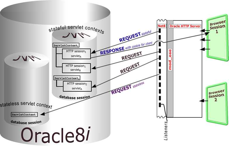

OSE was design for stateful Web applications. For these types of applications, each browser client is assigned a database session that keeps track of all stateful applications the user is executing in the domain. By default, all applications are considered stateful.
Stateful and Stateless Applications in Apache
You can configure Apache to use a stateless connection to OSE. There are certain applications for which a database session does not keep state information, with respect to the client. For these requests, each Apache process has a semi-persistent connection to a session used to process stateless connections to any client. Because each Apache worker handles only one request at a time, the stateless connection is used sequentially by different incoming clients. Stateless servlet contexts and stateless servlets must be indicated as such when published to the JNDI namespace.
The commands ServletContext entry and Servlet (see Oracle Java Tools Reference for each entry) in the session shell tool have a -stateless option that you can use to declare which application contexts or particular servlets are stateless. This information, used in conjunction with the Export command, simplifies management of the configuration.
Several Oracle APPS use the stateless model. It is advantageous in such cases to declare them as stateless when installed in OSE.
Stateful and Stateless Handlers in Apache
We specify whether a request uses the stateful or the stateless connection by specifying the particular variant of the handler to use:
       SetHandler aurora-stateless-server
       SetHandler aurora-statefull-server
       SetHandler aurora-server
Figure 5-2 Stateful Vs. Stateless Sessions

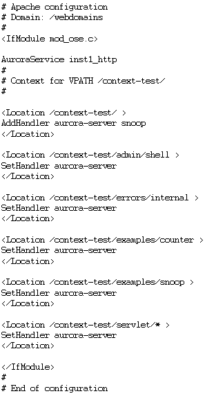

  1. Include this generated file, shown in the following example, at the bottom of the Apache configuration file, httpd.conf.
Example 5-3 exportwebdomain Command Output Results, webdomains.cfg
