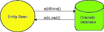

The EntityBean Methods: Load and Store
The main difference between entity and session beans is that entity beans possess persistent data that must be managed. When data is defined as persistent, it must be continually saved to or restored from a resource, such as a database or file. If the bean is destroyed, the persistent data can be restored without any loss.
The EntityBean interface, which all entity beans implement, defines the following callback methods for managing the persistent data:
Figure 4-4 shows how the persistent data within an entity bean can be saved to a database using ejbStore. In addition, the data is restored from the database through ejbLoad.
Figure 4-4 Persistent Data Management
The following are the methods from the purchase order example. The ejbStore method saves the purchase order items to the database. The ejbLoad method restores the purchase order items from the database.
