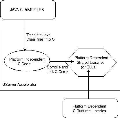

JServer Accelerator Overview
Most Ahead-Of-Time native compilers compile directly into a platform-dependent language. For portability requirements, this was not feasible. As shown in Figure 1-1, the JServer Accelerator translates the Java classes into a version of C that is platform-independent. This C code is compiled and linked to supply the final platform-dependent, natively compiled shared libraries or DLLs.
Figure 1-1 Native Compilation using JServer Accelerator
Given a JAR file, the JServer Accelerator performs the following:
  1. The classes, loaded in the database, are verified.
  2. The Java bytecodes for these classes are retrieved from the database and stored in a project directory where the JServer Accelerator was invoked.
  3. The Java bytecodes are translated to C.
  4. The C code is compiled and linked with the C compiler for your platform.
    JServer Accelerator translates, compiles, and links the retrieved classes on the client. For this reason, you must natively compile on the intended platform environment that this application will be deployed to. The result is a single deployment JAR file for all classes within the project.
  5. The resulting shared library is loaded into the
    $ORACLE_HOME/javavm/admin directory.
    The JServer Accelerator natively compiled libraries can only be used within JServer. Also, these libraries can only be used within the same version of JServer that it was produced in. If you want your application to be natively compiled on subsequent releases, you must recompile these classes. That is, native recompilation of existing libraries will not be performed automatically by any upgrade process.
