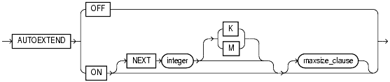

Text description of autoextend_clause

Use the autoextend_clause to enable or disable the automatic extension of a new datafile or tempfile. If you omit this clause:
Specify ON to enable autoextend.
Specify OFF to turn off autoextend if is turned on.
When you turn off autoextend, the values of NEXT and MAXSIZE are set to zero. If you turn autoextend back on in a subsequent statement, you must reset these values.
Use the NEXT clause to specify the size in bytes of the next increment of disk space to be allocated automatically when more extents are required. Use K or M to specify this size in kilobytes or megabytes. The default is the size of one data block.
Use the MAXSIZE clause to specify the maximum disk space allowed for automatic extension of the datafile.
Use the UNLIMITED clause if you do not want to limit the disk space that Oracle can allocate to the datafile or tempfile.
Restriction on the autoextend_clause
You cannot specify this clause as part of datafile_tempfile_spec in a CREATE CONTROLFILE statement or in an ALTER DATABASE CREATE DATAFILE clause.
