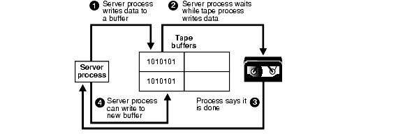

Figure 14-3 shows synchronous I/O in a backup to tape. The following steps occur:
  1. A server process writes blocks to a tape buffer.
  2. The tape process writes data to tape. The server process must remain idle while the media manager copies data from the Oracle buffers to the media manager's internal buffers.
  3. The tape process returns a message to the server process stating that it has completed writing.
  4. The server process can initiate a new task.
Figure 14-3 Synchronous I/O
Text description of stu81178.gif follows
