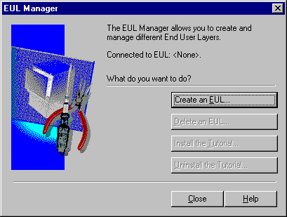

  1. Choose Tools | EUL Manager to display the "EUL Manager dialog".
    Figure 3-1 EUL Manager dialog
    Text description of eulmgr.gif follows.
  2. Click Create an EUL to display the "Create EUL Wizard dialog".

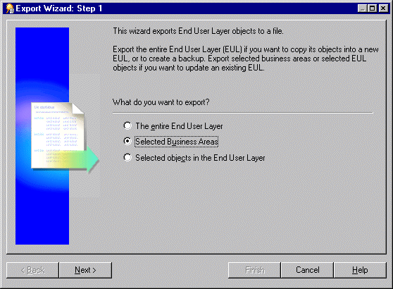

  1. Choose File | Export to display the "Export Wizard Step 1 dialog".
    Figure 3-4 Export Wizard: Step 1 dialog
    Text description of exwz1eul.gif follows.
  2. Select the The entire End User Layer radio button and click Next to display the "Export Wizard: Step 2 dialog".

How to export selected business areas using the Export Wizard
Use this option when you want to use the export file to update an existing EUL with selected business areas.
To export the selected business areas using the Export Wizard:
    Figure 3-7 Export Wizard Step 1 dialog
    Text description of exwz1ba.gif follows.
  2. Select the Selected business areas radio button and click Next to display the "Export Wizard: Step 2 dialog".
  3. Move the business areas that you want to export from the Available list to the Selected list.
    You can select more than one business area at a time by holding down the Ctrl key and clicking another business area.
  4. Click Next to display the "Export Wizard: Step 3 dialog".
