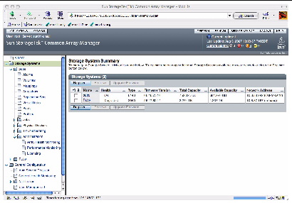

Navigating the Common Array Manager Interface
The browser interface provides you with an easy-to-use interface to configure, manage, and monitor the system. You navigate through the browser interface as you would a typical web page. You use the navigation tree to move among pages within an application. You can click a link to get details about a selected item. You can also sort and filter information displayed on a page. When you place your pointer over a button, tree object, link, icon, or column, a tooltip provides a brief description of the object.
The figure shows the Common Array Manager Storage System Summary Screen where you select arrays managed by the software.
Each page uses a form or table format to display data.
