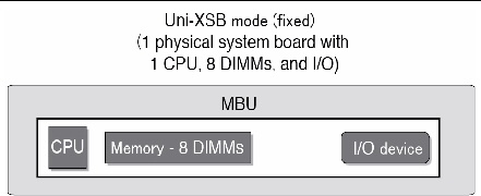

The entry-level server supports only a single domain, one CPU, 8 dual inline memory modules (DIMMs), and I/O. Midrange and high-end servers support multiple domains and one to 16 physical system boards (PSBs). One PSB consists of 4 CPUs, 32 DIMMs, and I/O. The I/O varies by server, and can include PCIe slots, PCI-X slots, and built-in I/O.
Entry-level servers have a fixed system board configuration by default; you do not need to reconfigure the system board.

The following figures show a PSB in Uni-XSB mode on entry-level, midrange, and high-end servers.
Note - On midrange and high-end servers, the CPU modules and memory modules are known as the CPU/memory board unit (CMU), and the I/O devices are contained in the I/O unit (IOU). The terms CMU and IOU do not have meaning for entry-level servers.
FIGURE 4-1 A Physical System Board in Uni-XSB Mode on an Entry-Level Server

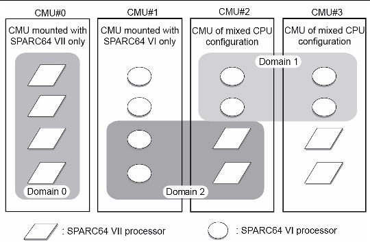

FIGURE 4-7 shows an example of a mixed configuration of SPARC64 VII and SPARC64 VI processors.
FIGURE 4-7 CPUs on CPU/Memory Board Unit (CMU) and Domain Configuration
Different types of processors can be mounted on a single CMU, as shown in CMU#2 and CMU#3 in FIGURE 4-7. And a single domain can be configured with different types of processors, as shown in Domain 2 in FIGURE 4-7.
