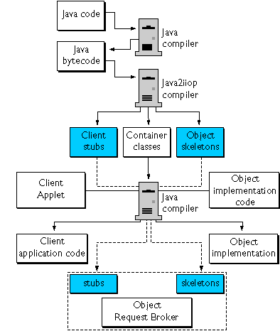

java2iiop
compiler (also called the Caffeine compiler) to generate client stubs and service skeletons from interface definitions written in Java instead of IDL. This chapter also explains how to work with complex data types. In particular, it explains how to pass by value using extensible structs. This chapter includes the following major sections:
java2iiop
compiler lets you define interfaces and data types that can then be used as interfaces and data types in CORBA. The advantage is that you can define them in Java rather than IDL. The compiler reads Java bytecode: it does not read source code or java files, it reads compiled class files. The java2iiop
compiler then generates IIOP-compliant stubs and skeletons that do the marshalling and communication required for CORBA.
When you run java2iiop
, it generates files as if you had written the interface in IDL. Primitive data types like the numeric types (short, int, long, float, and double), String, Any, CORBA objects or interface objects, and typecodes are all understood by java2iiop
and mapped to corresponding types in IDL.
When using java2iiop
on Java interfaces, you define and mark them as interfaces to be used with remote calls. You mark them by having them extend the org.omg.CORBA.Object
interface. (For developers who are familiar with RMI (Remote Method Invocations), this is analogous to a class extending the java.rmi.Remote
interface. Caffeine provides capabilities equivalent to RMI, and allows you to create Java objects that communicate with all other objects that are CORBA-compliant, even if they are not written in Java.) The interface must also define methods that you can use in remote calls. When you run the compiler, it searches for these special CORBA interfaces. When one is found, it generates the marshalling elements (readers and writers) which enable you to use the interface for remote calls. For classes, the compiler follows other rules and maps the classes either to IDL structs or extensible structs. For more information about complex data types, see Mapping of Complex Data Types.
Figure 8.1 Development process when using java2iiop
Running java2iiop

After generating bytecode, you can use the java2iiop
compiler to generate client stubs and server skeletons. The following example compiles the bytecode for CafMsg.class
. Note that the .class
extension is not used.
prompt>java2iiop CafMsg
