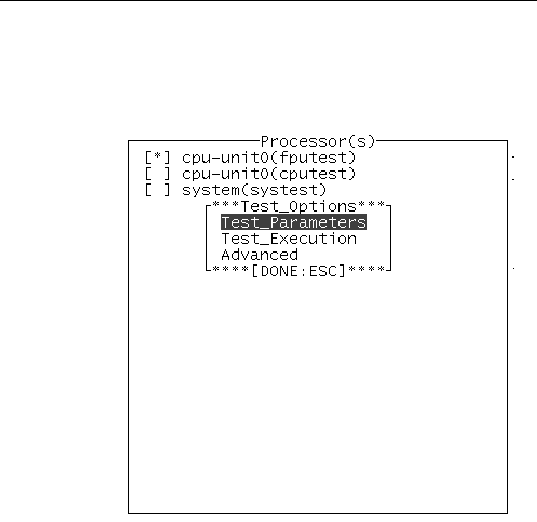

    a. Tab to the Test_Groups panel.
    b. Use the arrow keys to highlight the device group and press Return.
    At this point you can choose to access the group-level option menu instead by highlighting Option (instead of the device-level) and press return. Then go to Step d. Otherwise, the following steps will direct you to modify device-level options.
    c. Use the arrow keys to select a device from the device list and press Return.
    The Test_Options menu is displayed.
    FIGURE 5-7 Test_Options Menu (TTY)
    Screenshot of the SunVTS TTY Test_Options menu. Test_Parameters, Test_Execution, and Advanced are the options displayed in the menu.
    d. Select one of the option dialog boxes (Test_Parameters, Test_Execution, or Advanced) and press return.
    Note - For descriptions of these menus, see SunVTS Dialog Boxes.
    e. Use the arrow and numeric keys to modify the options in the dialog box.
    f. Use the arrow keys to highlight apply and press return.
    If you selected the Test_Parameters dialog box, you will be prompted to apply your changes to one of the following:
    FIGURE 5-8 Apply Menu Choices (TTY)
    Screenshot of the SunVTS TTY Apply menu.

single-step bulletOpen the Test Advanced Options dialog box from the group level or device level you want to lock as follows:
    a. Move to the Test_Groups panel.
    b. Highlight the group that has the device for which you plan to set (or unset) a lock, and press return.
    The group devices are displayed.
    c. Highlight the device and press return.
    d. Highlight Advanced and press return.
    The Advanced options menu is displayed.
    e. Highlight the setting for the Test Lock and press return.
    f. Highlight enabled (or disabled) and press return.
    g. Highlight Apply in the Advanced menu.
    The lock is set (or unset).

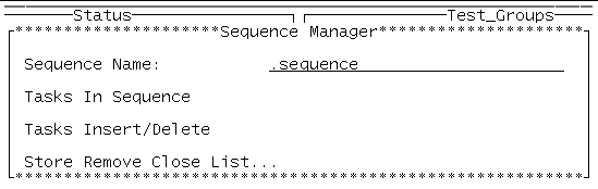

procedure icon  To Create a Sequence
1. Invoke the Sequence Manager menu by selecting the Sequence Manager (FIGURE 5-12) in the DSched Control menu (FIGURE 5-10).
FIGURE 5-12 Sequence Manager Window (TTY)
Screenshot of the SunVTS TTY Sequence Manager window.
2. Enter the name of the sequence file you want to create in the Sequence Name text field.
By default, the Deterministic Scheduler displays the text field with a .sequence suffix. This filename suffix is not mandatory.
3. Select Task Insert/Delete -> Insert Tasks in the Sequence Manager menu.
4. Select Insert Tasks and press return.
The Tasks Available menu is displayed.
FIGURE 5-13 Tasks Available Menu (TTY)
Screenshot of the SunVTS TTY Tasks available menu showing cputask1a, stresstask, nettask1, and fputask2 as available tasks.
5. Select a task from the list and press return.
This displays a menu with Insert Task as the only choice.
6. Press return.
The task you selected is inserted into the sequence.
The order in which you add tasks is the order they will be run in the sequence, with the first added task running first, and the last task running last. However, you can insert tasks into specific places in your list of tasks as described later in this section.
7. Repeat Step 5 and Step 6 to add additional tasks into the sequence.
Note - Use the <Esc> key to move back to previous menus.
8. Select Store in the Sequence Manager menu (FIGURE 5-13) and press return.
Your sequence is saved for future use. To run the sequence see To Run the Sequence.
